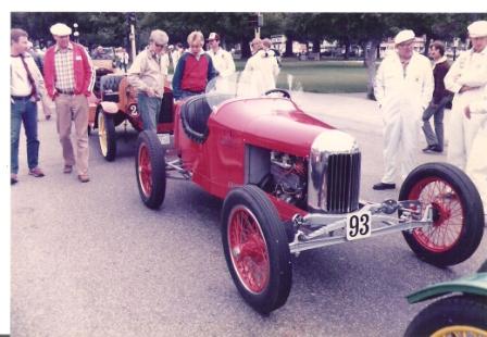

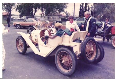

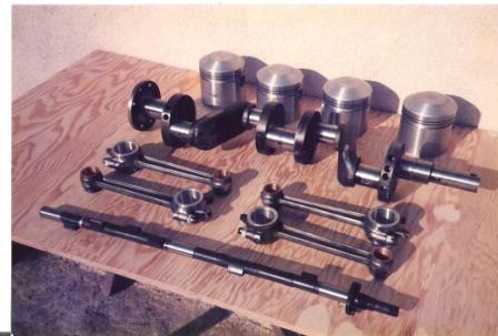

  1. Been thinking about this for a while. Seems like there may be some interest in T speedsters here, so why not a picture thread? I'll get it started with pics of one I built in 84. It's a 15 with Rootlieb fenders, hood and aprons. The seat, cowel, gas tank, and tool box were made by Wayne Erickson from patterns I made. The engine is a 27 block with a Fronty head, Model A crank and rods, Egge pistons, and a cam ground to Winfield specs. I used an overdrive from a 50's Studebaker, and a Ruxtell 2 speed rear end. We had a lot of fun with this car. Ran in the San Jose Speedster endurance run from 84 to 95. I sold it in 95 to buy my current roadster.

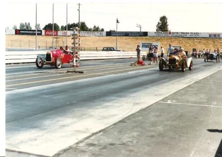

    The drag strip shot is from Portland International Raceway. We did the Portland endurance run a couple ot times, and the local club booked the strip for a play day on Monday following the endurance run. We ran the 1/8th mile and had a ball.

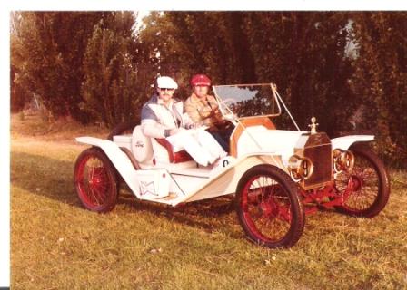

  4. Here's the speedster that started our involvement with T's. Dad built this one in 81 from a Rootlieb kit. he used a 26 block with a somewhat rare Ricardo high compression flathead. dad learned to drive his dad's T when he was 9 years old on the farm. He had many good T stories from when he grew up with T's in Nebraska. That's me and my brother in dad's speedster before I built mine. We were about to take off on the San Jose run in 83. Note the Bud cooler lashed to the running board. We were ready for anything!

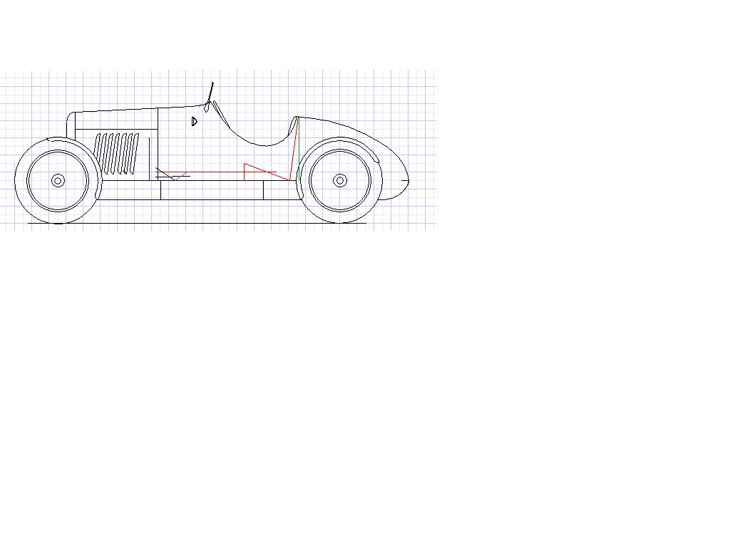

  8. Still REALLY early on in the build stage (read as HDF pattern almost done), but here is my goal:

  12. The Fronty wasn't what I hoped it would be. They made 3 versions of the rocker arm Fronty heads. The commercial, which was for truck use, a street version for passenger cars, and the "R" racing version. The difference was the depth of the combustion chamber. I had the truck version which had 1 5/16" deep chambers. Even with the maximum pop up on the Egge pistons, the compression was below 6:1. Couldn't do much with milling it because there were actually 3 different castings, and it would have been way to thin with enough milled off to do any good. I used a side draft carter carb off a Chrysler marine engine, the same as used on Corvairs, and the 53 Corvettes. I ran better than a stocker, but I wanted more. I sold the Fronty head, and got one of the "T-Go" heads that Jim Culbert designed. It was mostly copied from a Rajo BBR head. It was aluminium, and used valves and rocker assembly from the slant six Chrysler engine. it wound up with 8.2:1 compression. I used a side draft 48mm Webber carb, and a Bosch front plate with a SCAT VW distributor. The A crank was drilled for pressure, and I used a VW oil pump driven off the back of the cam. Damn that thing ran! Tore up the clutch, and had to use a heavier clutch spring to hold the power. Also had to balance the trans drums because of the RPMs. I made two passes at Portland, and ran almost 80 in the 1/8th mile. WAY faster than the car felt safe!!

  14. That should be a nice one. Keep us posted on the build.
