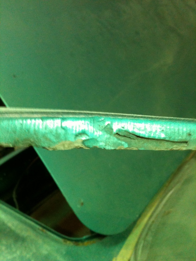

After much trouble I got the seized engine out and the other engine in. I also got all the original wires from another falcon I only had to repair 2 wires on the new one, but used wire from the old one so all the factory colors are there still.
I have been working on it here and there. I also made some lowering blocks for the rear that are 3" (maybe too much) and hit the front with a little heat. Thinking of getting another set of springs and cutting them down instead. Gonna narrow and box the lower control arm and relocate the stabilizer bar underneath and pie cut the upper control arm to keep a better BJ angle. Still want to ad airbags as soon as I can afford it.
Today I was putting on the water pump and at 13 lbs of torque the top bolt broke.
I decided to drill it out and retap it, easy right? HAHA fuc no. Had to pull the grill and to do that I had to pull the bumper.
I decided to fix another problem while I was at it, the radiator is too close if mounted correctly. The P.O. had the radiator mounted behind the radiator support, in order to do this he bent 2 tabs back and then shoved it behind and folded them back. So I cut the mounts off and made my own.
So it was a long day but I got a lot done.
