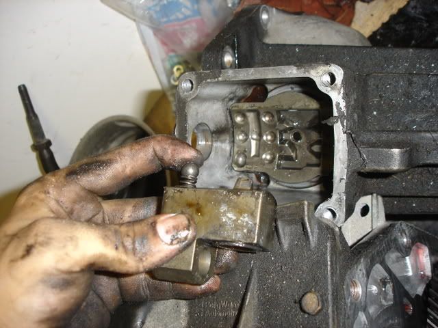

We'll start by romoving the shifter if you didn't already remove it at the junkyard. Remove the 4 bolts and pull it out. Note the plastic bushing that the shifter ball rides in, I'd pull it out and set it aside so it doesn't fall out and go under your workbench later.
Then go ahead and drive out the roll pin that holds the shifter assembly to the shaft. Make sure the gearbox and tailshaft are well supported and drive it all the way through.

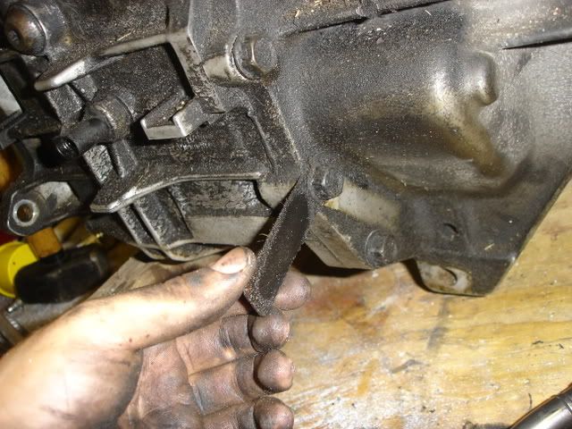

Now you can remove the 8 bolts that secure the tail housing to the gearbox. Note in the picture the tag I'm holding. That's the tag with the id number for that particular tranny. All the jucy info for the trans is on that tag. The numbers on the case don't tell you anything important.

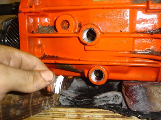

Before we continue on I recommend putting some pig mat or other absorbant or a pan under the trans to catch the residual fluid that's still living in there. Once those bolts are out (make sure you get all 8) go ahead and tap on the tailhousing to seperate it from the gearbox. I use a plastic mallet since it's aluminum. If you don't have a deadblow or something soft try putting a piece of wood between your hammer and the case before wacking away. I also wouldn't reccomend prying since it's soft and there's no gasket just RTV so you don't want to scar that mating surface.
Now that the seal between the gearbox and tail housing is broken you can slowly pull the two apart. Keep an eye on the shifter assembly while you do this. The shaft slides out and stays with the lid on the gearbox and the rest of the assembly stays with the tail housing. When these to pieces seperate the spring and ball from the shifter assembly will try to take off and hide under your bench, don't let this happen.

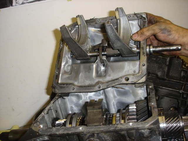

Now that we have those apart we can set the tail housing asid for now and get the lid off the gearbox. Remove the bolts from the lid (note 2 of them ar dowelled). Once all the bolts are out tap on the lid to break the seal between the lid and the gearbox. I'm pointing at a good place to tap. Remember gently tap and no prying.
Once the seal is broken push the lid toward the drainplug sid of the trans. Just use your thumbs. You can see where I'm pushing with my left thumb and if I wasn't tiking a picture my right thumb would be pushing where the shifter shaft comes out of the lid. After you push it all the way over the cover should easily rise out of the gearbox.
OK that's pretty much it for that one, now you can repeat the process on the other unit. Now for a little intermission, you can see that the trans in the pictures so far (the S10 unit) is a filthy mess, so I took it to the car wash and pressure washed it which I should have done before I started. And we should also discuss the oil flinger for the overdrive cluster. There are different flingers for different tailshafts and the casting in the tail housings is different. If mismatched the flinger and the housing might not get along and the gearbox won't seat fully to the tailhousing, or you might not get the proper amount of oil slung on the gear clluster and prematurely fail your new T5. So all this bing said, use the plastic flinger from the trans that the tailhousing came from, or make sure that the one in the other trans is IDENTICAL.

Put the spring in the shifter assembly and then the ball. I use vasaline to hold this stuff together. I also started the roll pin in the shifter assembly to make it easier once things are lined up. Go ahead and RTV the back surface of the gearbox now. Then put the trans in neutral with the drift and put the shifter assembly into the top of the tail housing in the neutral position and hold it down with the spring compressed. Hold all this together and slide the tailhousing onto the tailshaft and the shifter shaft into the assembly in the top of the tailhousing. Now it took some fiddlin around but I got the holes to line up and drove the roll pin back in place. Then I put the bolts back in and torqued to the desired spec. Also torqued in some sort of criss cross pattern.
Go ahead and throw the shifter back on there (don't forget the plastic bushing) and you're ready to weld a handl on there that works for your application and make sure you pick out a good shift nob to top it off.

I'm gona assume that you need the factory gear lube. I could only get this stuff from Chevy. Very expensive down here. Its very light Wt. But didn't want to mess up with putting in heavy stuff and messing some thing up. Any recomenditions, or advise on that one. Ice man
