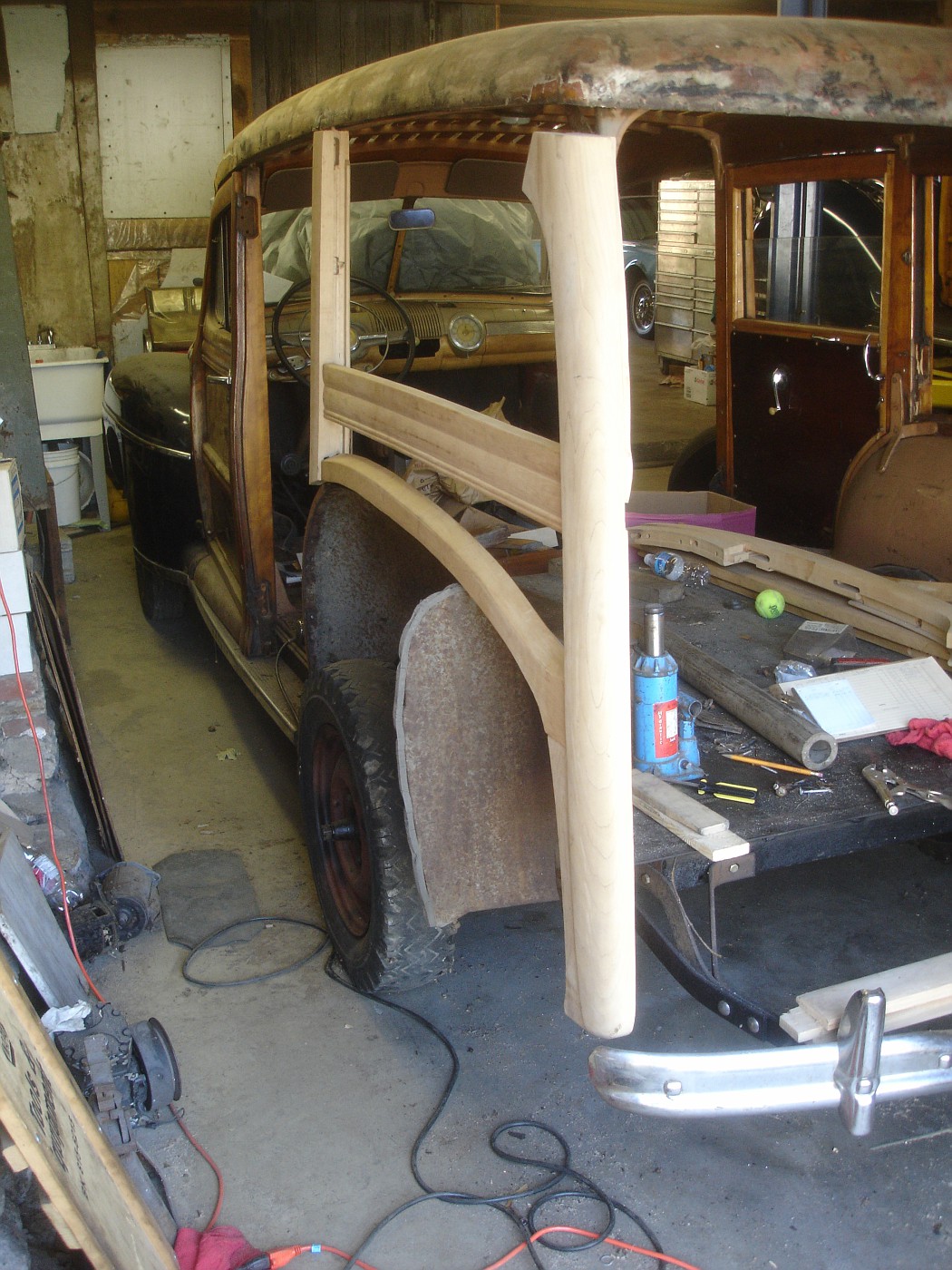

    Although I have two woodie wagon projects of my own, I couldn't pass up the oppertunity to take a summer job at a local restoration shop. This "job" has proven to me more fun than work, and I don't know how I am going to go back to teaching in the fall..
    the owner of the shop, whom I have known for quite some time , recently purchased a 47 ford woodie locally. This car had been in possession by the previous owner since the 70's and although a large number of replacement parts were accumulated for the car, little progress was made toward restoration.
    one of the BIG important pieces that came with the car, were replacement wood pieces from Cincinnati Wood Works. Apparently some time in the 80's the wood was purchased but never installed on the car.
    Details to follow here are a few photos from my first 3 days of work.

    not exactly.. I've had another 46 apart (well parts of it anyhow)
    this is the first KIT I have done, i see now why most people only want to replace all the wood.. as it would likely be less work!
    here's a shot from yesterday's roof removal!

    just the wood.. however the rear fenders had to come off to remove the wood because the fenders attach into the rail over the rear fender
    overall the car is in excellent shape, just needs a few pieces of replacement wood..

  24. sawzall
    Joined: Jul 15, 2002
    Posts: 4,724
    sawzall
    more progress:
    this shot gives an idea of how much material must be removed from the "kit wood"
    unfortunately this all comes back apart (again) monday the c pillar needs more fitting where it sits on the inner fender. I'm looking at an hour to tear all the stuff back apart.. and 10 minutes to router out a deeper recess.. Gotta love these things.

    sawzall do you use glue in the final assembly and then screw it together
  26. sawzall
    Posts: 4,724
    sawzall
    yes..
    sorta..
    its currently screwed together (in the factory screw hole locations.
    although it looks good. we arent anywhere near final assembly yet.. the wood will all be sanded lightly and finish applied before any glue.
