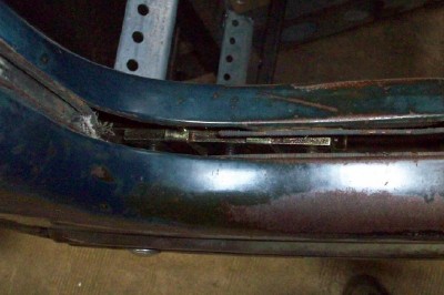

    Put the door cups back on the hinges and set them to the center of the adjustments, and hang the door over the hole. I used a small ratchet strap to hold in in place.
    It wont go all the way in (hits the hinges), make sure that you have it centered in the hole and make sure that the bodylines are square.
    Mark around the hinge cups and remove door, cut just inside your lines and dont cut to deep, need to sneak up on this. It takes a couple cuts but its easier to weld if it fits tight!
    What you are looking for here is to get the hinges just inside the skin of the door so the door panel needs no notches. You also need to watch to make sure that the hinges are not so deep that the foul the window tracks
    I ended up a bit deep and at the wrong angle so I cheated! I cut the pivot bar on the back side and bent it just enough to get the hinge flush. If you are not that confident in your welds I would recommend getting the adjustable hinges, they eliminate this step.
