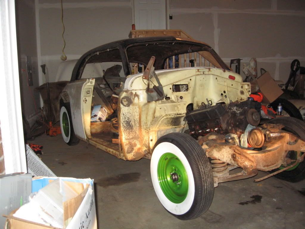

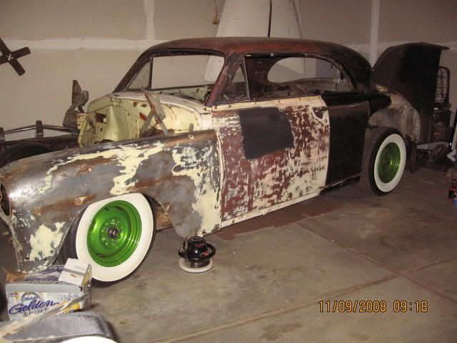

    Hey guys I know it's been awhile but I thought I would finally post some new progress pics of "Lucky Lorraine"...my 51 Plymouth Belvedere. Our club decided with all of the business going around this summer with everyone we all decided to take the summer off and get going again in the winter. Well with winter finally here we are all back at at. So here are some pics of what we have accomplished in DAY1. We cut out that dented, cottage cheese looking old quarter panel and rolled out a new one and got'r tacked in nicely. We also tossed around some more cool ideas for the tranny mount and got started on that. The big accomplishment we got done was slamming the front out using all the stock components. Still got about 3" to go in the back now to give it that perfect stance I want... Check'm out...Take care guys...Thanks...

    Lorraine? I thought for sure "Cum Dumpster" was the front runner.;) Anyways, is the back of the engine supported in the first pics? Reason I ask is seems to slope towards the firewall quite a bit. Is that going to be an issue down the road? (pinion angle, carb angle,) I don't know either so I thought I'd ask.

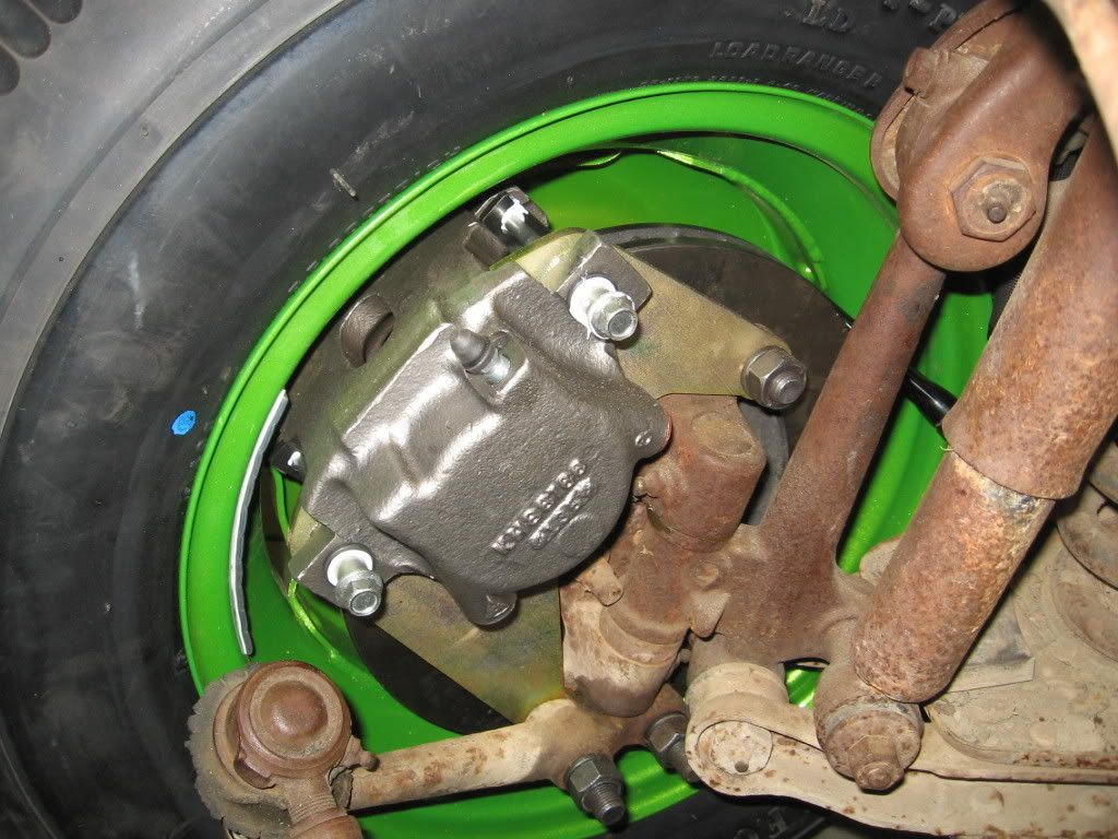

    lookin good ,those wheels really do pop with right light on them. weve got a 52 cranbrook thats gonna be put in the shop to get started on very soon I was curious about your front brake setup where did you get it and how did you drop that car so much with stock parts in the frontend?

    Cool car, I love the roofline on that model. I too was wondering about the rear trans support. If you are using an automatic with that front engine mount, you will need some kind of center support at the bell housing. If you run just the front mount and the rear tailshaft mount, there is a good chance the trans will crack right across the bell housing. This is a fairly common problem. It creates a lot of stress in the middle. There is a kit available for the tri-5 Chevys for this type of application that would work fine in your Plymouth.

    Yeah well it all works out cause maybe "Lucky Lorraine is a "Cum Dumspter" lol...but yeah in the first pics there the motor was not supported or better yet where it needs to be for the final layout. The tranny is just sitting on a 1" square tube welded in for now. Thats probably why you guys are thinking it's angled all weird, which it is but thats definitely not where it needs to be. We did however start with the custom tranny mount, which will be removable and what not this last Sunday but did not get it totally finished. But yeah we did however figure the angles out and meaurments out and stuff and when it's sittin in there where it needs to be it's nice and snug and fits pretty good.

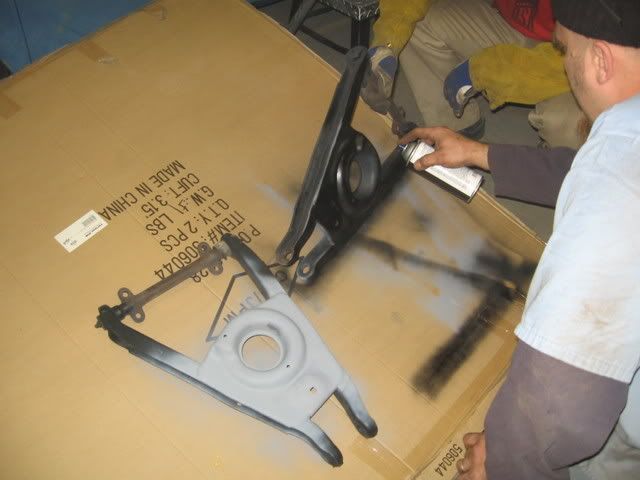

    We took the coil mount on the lower A arm, cut all the rivets off and welded it onto the bottom side of the A arm. That way it doesn't change the spring rate and lowers the car a solid couple of inches. As it sits now the spring was shot on the passenger side so we cut out one total coil from both sides. Pugs will probably have to get new springs, and buy dropped spindles. Or just get lowered springs to replace the shot, cut stockers. That'd be the best bet.

    This is basically the only pic I have of the A arms off. Basically if you were to something like this you just dissasemble them off the front suspension, take the springs out, cut the rivets off the A arms and mounts then weld them on the backside of the A arms, use the rivet holes as guides I beleive to drill new holes and and weld on the mounts...then just cut a whole coil out of the springs...if you have any other questions I am sure -J- can answer them...
