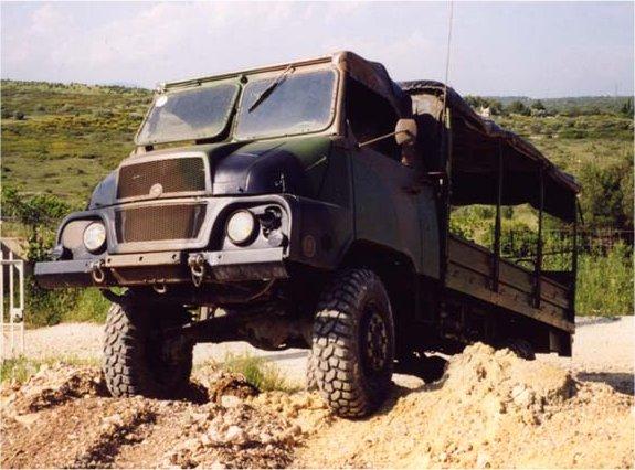

    the french flat was in this :
    it's called a "Marmon" made by "SIMCA" the marmon got a 4" crank. I beleive it's was made until the early 70's. You can found sometime "military rebuilt" or new ones, in sealled nitrogen box.....
    There is also a french flat called "Cargo", but it's the same crank than Ford. Watch out when you buy one.
    picture from :
    http://r2087.free.fr/new/pages.php3?num=138

    Tres UGLY No?:)

    And YES Marmon truck are ugly -the one picture is the nicer ...-

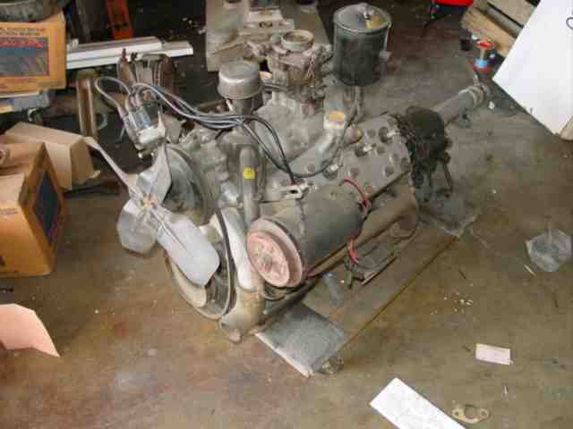

    Heres my german flathead:
    Was in a wooden box from year of production on, produced in Cologne in 1963 for the german army. Its a G29T, found it in 2005.

    Mark Kirby (Motor City Flatheads) had a few of these things at his old shop in Dundee Michigan. He gave me a ride in one once and I thought we were tip the damn thing over. They are really pretty cool though.
