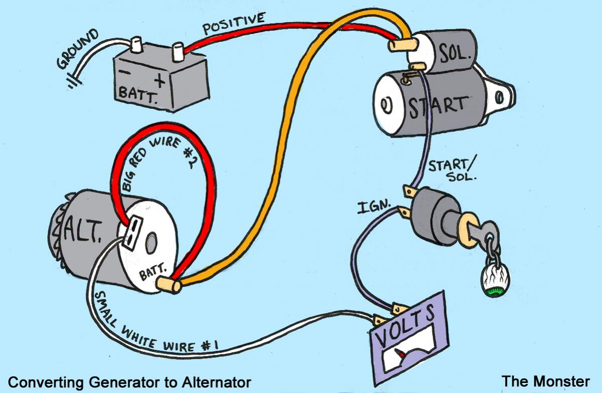

Excellent. I assume you could also just hook the #2 wire on the alternator directly to the battery post on the alternator? Yeah, I'm that stupid about wiring but had to ask. Thanks.
offline   Reply With Quote
Sponsored Links (Register now to hide all advertisements)
Old 04-25-2008, 06:15 PM   #4
gahi
Join Date: Jun 2005
Location: Moab, UT
Posts: 740
Default Re: Chevy Alternator Wiring Diagram
ya, you can hook it direct.
wtf! no color?
YOu can also loop Bat and number two at the alternator...
Then you only have the gauge wire (if you have one) and the line back to the battery to route.
Get rid of the gauge wire and you're down to a homemade one wire alternator.
online   Reply With Quote

You need the indicator lamp or a resistor to exite the alternator.

you dont even need wire #2 the connected through a diode interaly. its just a sense wire if you use it

I didnt want to run a warning light on the excite wire and tried several way to hook it up, finally hit on a good way. Connect it to the unused pole on the starter that was originally used to supply power to the points during cranking, the momentary connection is all you need to get the altenator working then upon shutdown it cant backfeed the ignition circut. Works for me have done it several times. Just my 2 cents worth.

39ChevyRatRod, I tried your idea of using the resitor bypass on the soleniod on my bucket today and it seems to work rather well. Thank you

found this thread thru a search and rather than start another wiring thread ill just post my question here.
i modified the above diagram (the second one). please let me know if its ok? *note that the ignition switch in my diagram is for a 50 Truck so it does not start the truck therefore i added a push-button start.
other thing i would like to know is on the above diagram the alt and ignition switch have a wire that go to Batt. what exactly does that mean? excuse my lack of electrical knowledge.
my modified version of the above diagram...
thanks.

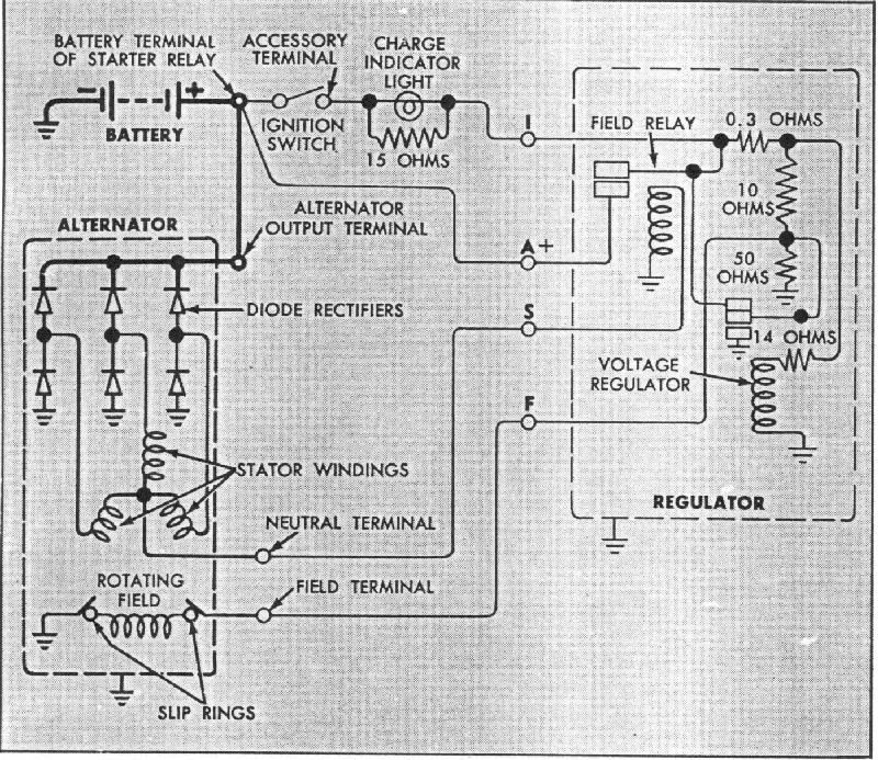

Here's one that's similar to the first one but with external regulator. It's from Petersons "Basic Ignition and Electrical Systems", a Hot Rod Magazine Technical Library book published in 1971 which I bought back when I had pimples all over my face (well, more pimples anyway).
