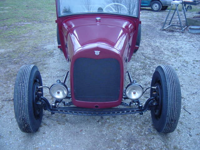

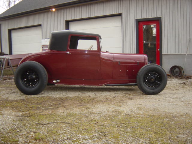

    Tman...I used 30/31 hood sides on my sport coupe. According to C9's measurements that would be about a 4" stretch. I just wanted to use the hoodsides. I have a sbc with an uncut firewall.
    I did the same as Zach at the firewall. Had to notch the bottom of my grill shell.
    Clark

    Clark
    Also put the axle just infront of the grill.
    Clark
  22. Thanks Clark, maybe I miseed a pic of the axle? Got a shot of it?

    Clark
    I didn't realize I stretched the thing so much. I would guess the wheelbase is about 8" over stock.....should help the ride.
    Clark
  24. You can telll it is stretched now that there are pics of shorter cars to compare too.
