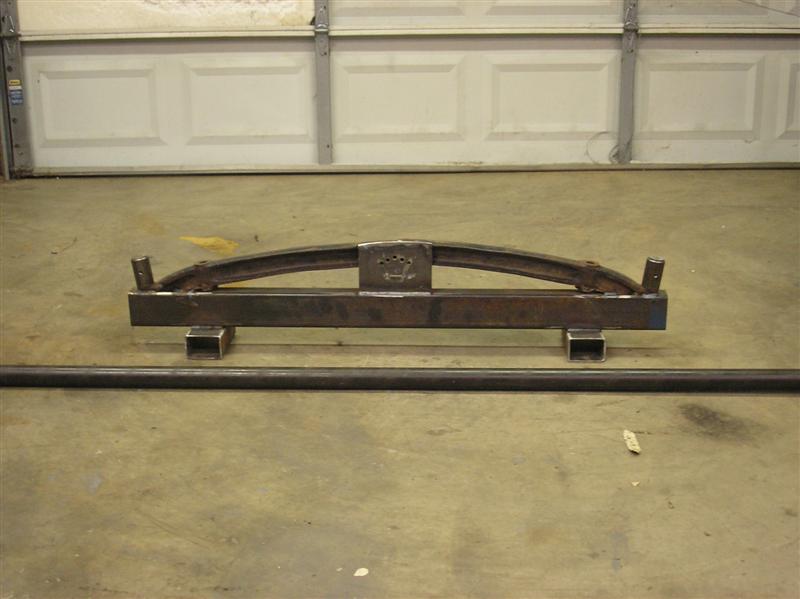

    I am building a Dragmaster style dragster. I have an orginal to copy. And when it came time for the front axle I use the orginal Dragmaster axle as a pattern. And used a ford axle as material to make a jig with. The dragster axle is shorter than the Ford so it needed shortened. So i found the middle of the axle and measured on each side of it and took out the same amount on each side. Well I messed up damn tape measure must be defective or something. ha, ha. But it dont mater all its just a jig and the middle isnt the importiant part any way. Then I put the king pins thru both axles to hold them together. Found a piece of 2x3 .125'' and cut the top out of it and set the ford axle down in it and welded it in. Now the jig was finished time for making the real axle.

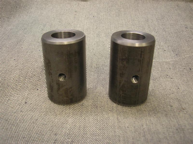

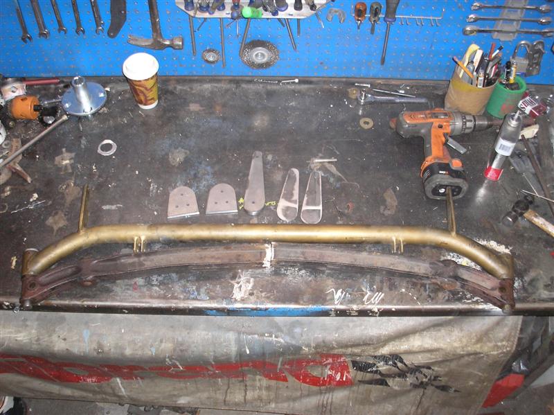

    For the axle material I used 1 5/8'' .120 wall 4130 moly. Put it in my bender and bent both ends. Then Tom Masa machined me the king pin bosses. Took the axle to work and put it in the mill and fish mouthed it to accept the bosses. I suppose this could be done in a drill press with a hole saw too if you had a big enuff vise to hold it. Next I dropped the king pins thru the new bosses and into the jig. Set my tube inbetween them and welded it. Got my self a dragster axle.

    Question, how do you remove the axle from the jig with the caster you have in the kingpin bosses? It does'nt look like you could get it off after welding it.
  15. revkev6
    Joined: Jun 13, 2006
    Posts: 3,350
    revkev6
    from ma
    looks like you tap the kingpin out of the ford axle

    Yes there is a hole in the bottom of the jig and you tap out the king pin.
