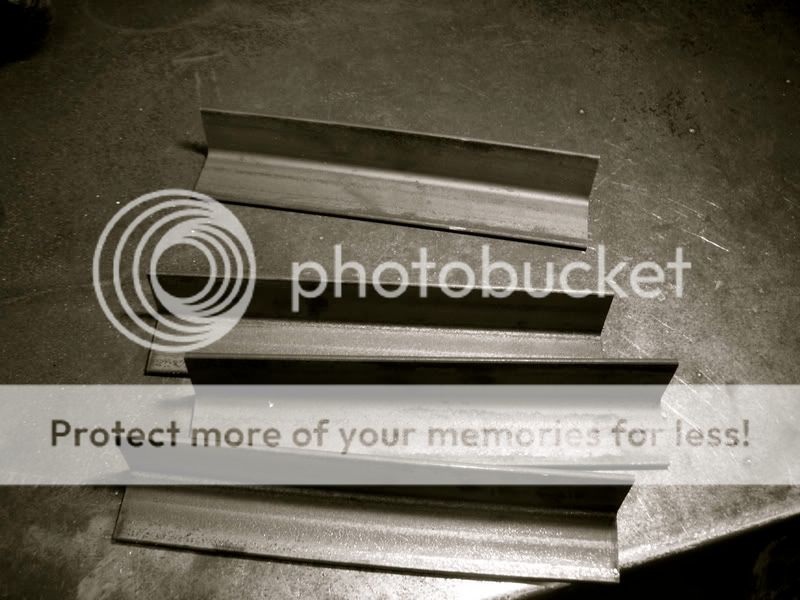

Arrow TECH: Adjustable wheelstands, no more guessing on the ride height, while you build.
I like using these adjustable wheel stands I made, mainly because I find that the actual wheels and tires are, pretty much in the way most of the build and second, these are adjustable to accommodate, different size tires, so you can build to ride height, without guessing what it's going to look like.
Also a big plus is that these roll and most importantly they roll where your want them to roll, being able to roll your project sideways makes your shop a whole lot bigger.
This adjusts from 32" tires all the way down to 25" tires.
So here it goes.
Here is a scale drawing I made, if it prints correctly you can take measurement off, of it. 1'=3"
Hope it all makes sense.
These dimensions are for a 5 on 5.5" wheelpattern.
#1: I cut 2"X2" angle to 12" long.
#2: Drilled 1/2" holes, 1" from the top, 5/8" from the edge, in 1" increments.
#3: I cut 13" X 4" X 1/4" plates, were all the parts will be welded to.
#4: Bolt the drilled angle pieces to the hub, making sure everything is square (important). The bolt holes have to be 5 1/4" on center, otherwise they wont fit.
#5: Weld the 13" plate to the two angle pieces.
#6: Let cool down unbolt and check for fit in different holes (ride heights) etc.
#7: Weld or bolt the casters (5 1/2") tall in my case to the bottom of the plate.
#8: Clean/grind everything to make it save and paint as desired.

I don't want to sound nitpicky- but I would put a "gusset" piece between the two uprights and welded to the flat bottom plate. So the bottom plate would in effect be an "L" shape across that area.
You could, I guess, but once the wheelstand is bolted to the hub, its solid.
It is really strong as is, thou.

looks good.. does the whole thing want to rotate with the hub when you push it?

Nice. I also made some adjustable stands a while ago. One tip I want to give which is something I learned the hard way, so to speak. You will need to space the castor wheel much further apart. When you push the whole frame sideways all will be fine but it's when you push forwards or backwards that it's gonna want to topple over.I was quite surprise at how easily mine would topple over so I added some angle iron to the bottom and move just 2 of my 4 wheels further apart and now they don't topple anymore. Look at my 3 oic then you'll see what I mean.

But sitting here, it occurred to me that I have BOTH 5 on 5 1/2 AND 5 on 5 on this current project.
So ... how about a gusset welded solid to ONE upright and the BASE and on the other upright have a couple of holes - and NOT welded to the base or the gusset - that could be bolted to the horizontal gusset that has SLOTTED holes.
That way your adjustable wheel stands, - vertical - could now fit TWO commonly used bolt patterns.
The slots would still allow the vertical adjustment, as well as side ways adjustment for the different bolt patterns.
