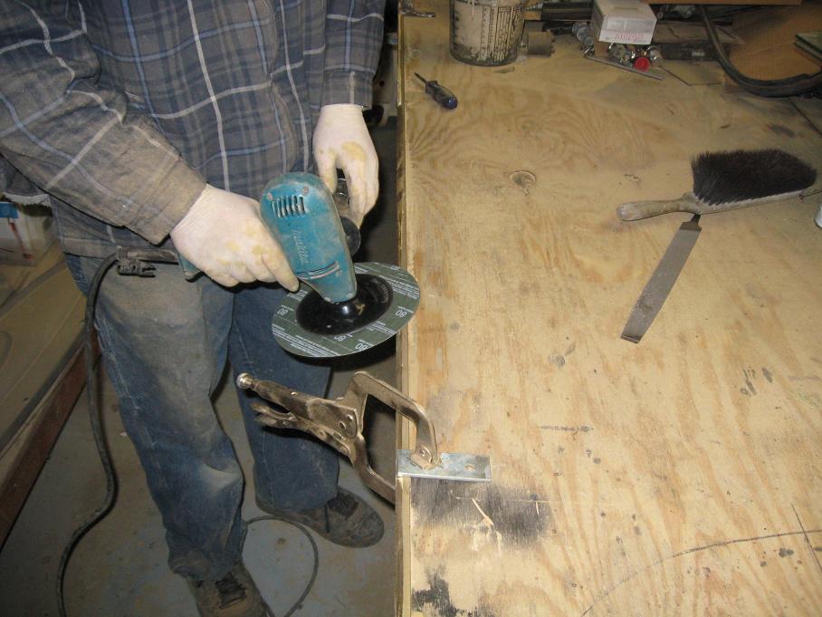

    2. The next step is your tools. I use a 7" disc sander with 80-120 grit paper to give it a ruff shape, a few different sizes and SHARP bastard files. And last but not least you need an oxy/act set up to bend and weld these things up unless you have a tig.

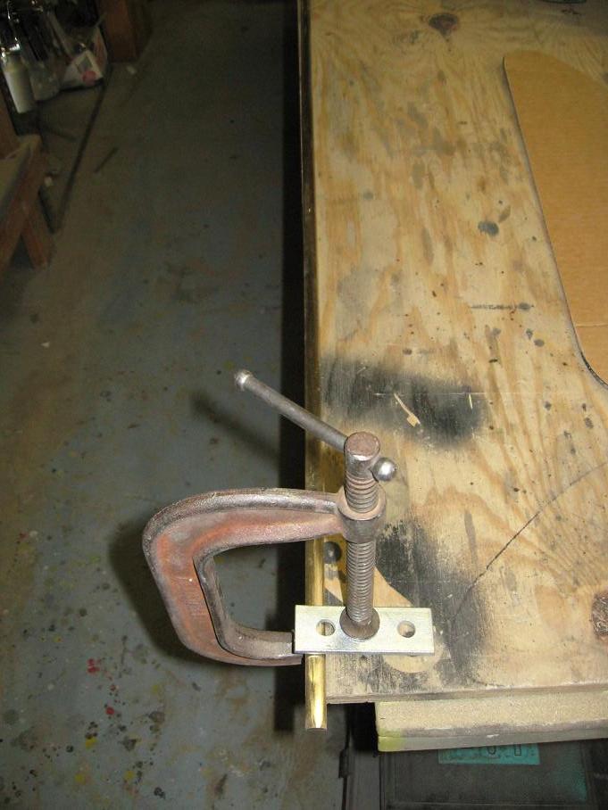

    3. The fun part begins, you want to have a work bench (long ones are nice) you can clamp the brass to on the edge, i use some little flat plates and C-clamps or vise grips to get the job done and then start shaping.
    be careful not to take to much off. the trim shape is usually thinner at the top and fat on the bottom with a small radius. ill start to ruff it to shape not worrying about the smoothness of it or it sharp edges, the file will take car of that. once you get one side ruffed take your SHARP file and start blocking the brass to get it nice and perfect to the shape you want. than flip the brass around and repeat the the step.

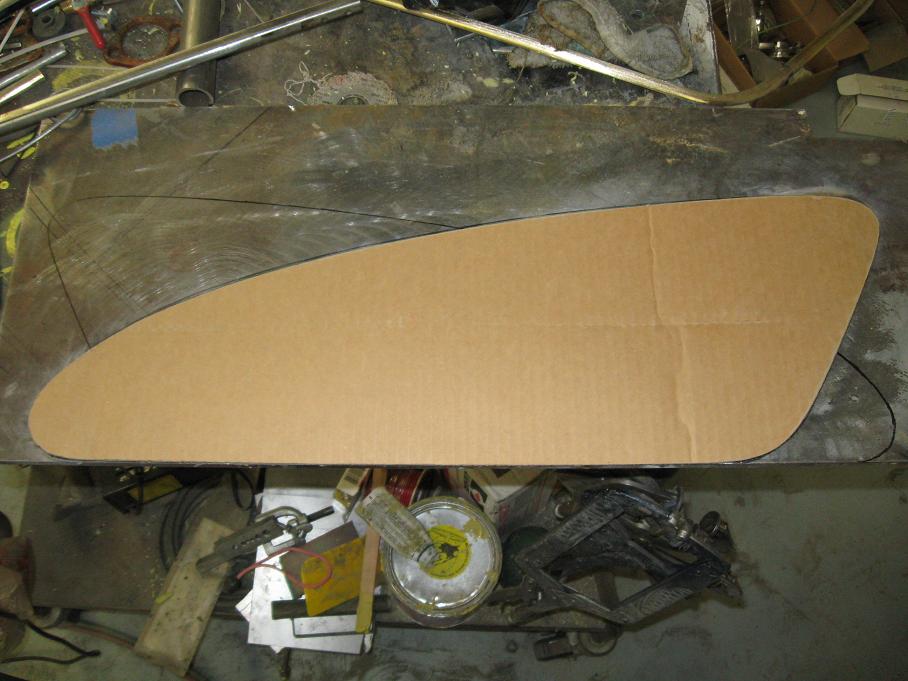

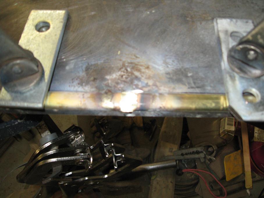

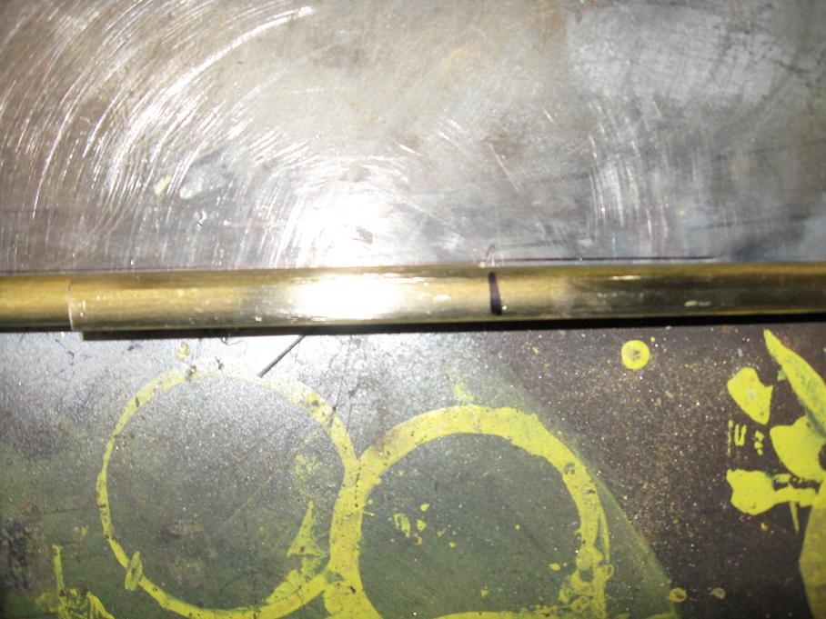

    4. Next is to make a damn near perfect template of the window opening. once this done i trace the template with a magic marker to piece of 3/8" plate that i have on a cart.
    5. Next you want to measure the distance around your template to get a ruff estimate on where to cut your brass.
    6. Next i like to clamp the brass to the plate matching the baseline of your template and pick a spot where you want the seam to be, not to close to the radius's.

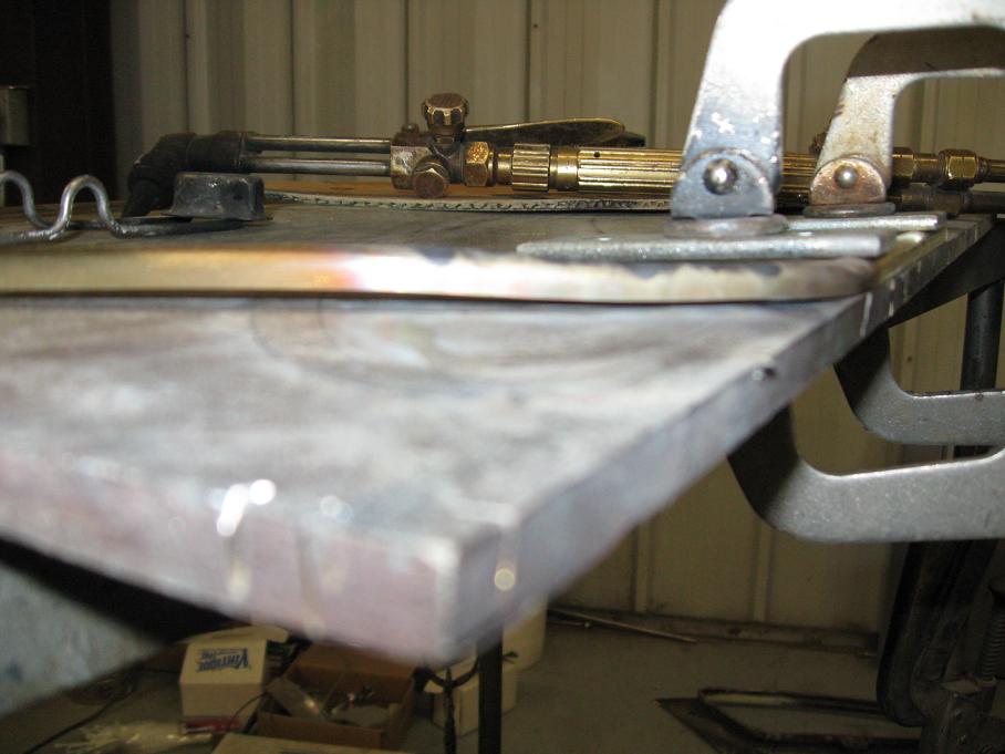

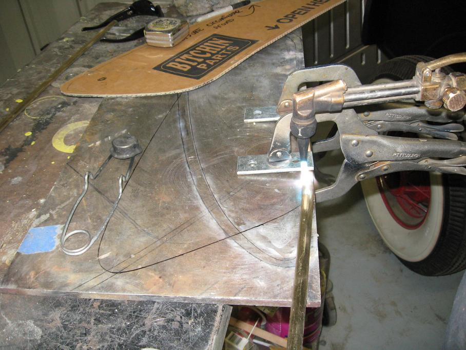

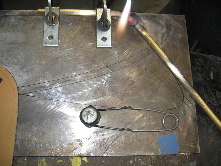

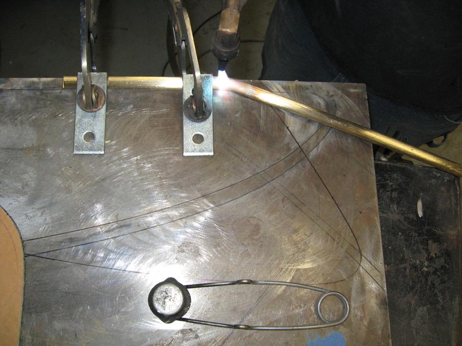

    7. Next light your torch up and start bending. you want to be careful with this process brass is fine one minute the next its golden blob... when doing the tight corners the brass has to be CHERRY RED or it will fracture in half and that is when you start yelling obscenities!;) work your metal about 1/4" at a time on the tight stuff heating it red, bending, let that spot cool a little for a few seconds then move over and repeat the step until you have your bend. the brass will tend to "curl" some when you bend it but dont finish your bend first.
    8. next after the brass lines up with your next line clamp it down and heat the newly bent corner and flatten it out by squeezing it with the clamp and the holding plate. the clamps by themselves will dent the brass so be careful.

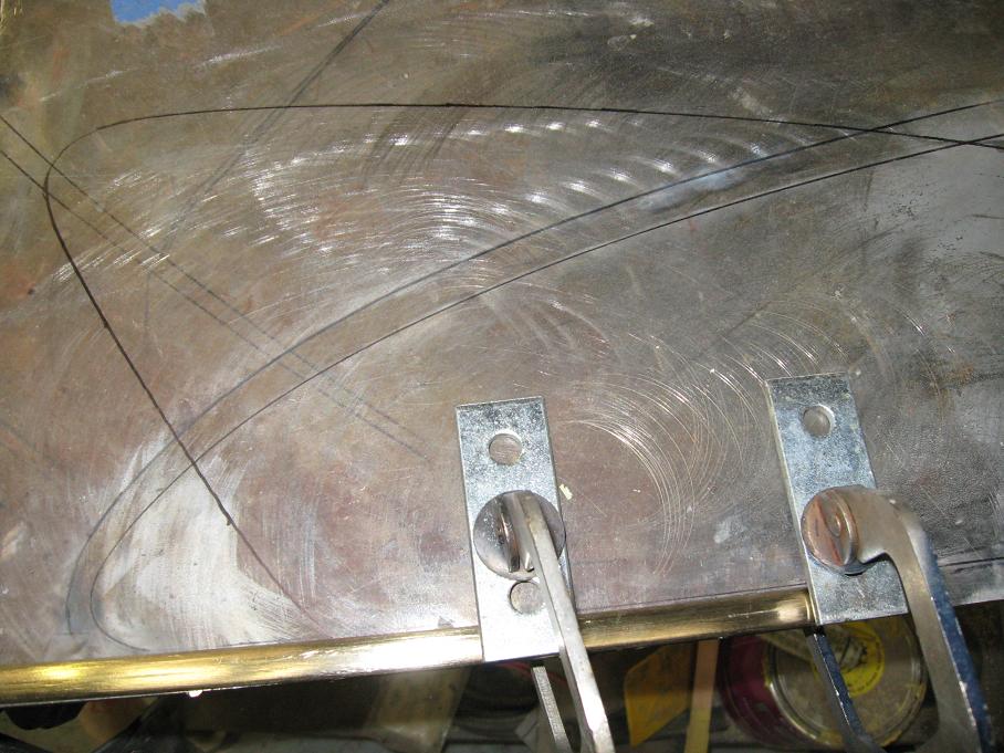

    9. Next reposition your clamps like in the last picture and continue your bends.
    10. Next on the larger curve i will heat the brass every 1/2"- 3/4" depending on the curve, letting the metal cool a little before the next little bend. don't forget to move your clamps along unless you have enough to hold every side down to make sure you stay accurate to your line.

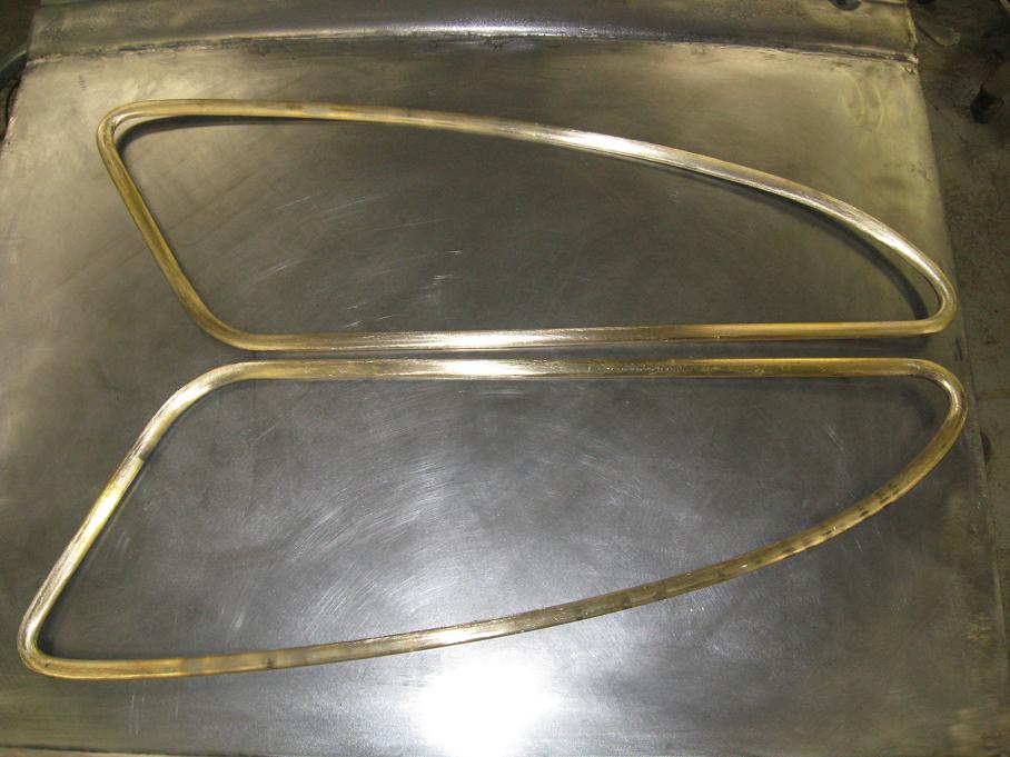

    11. Once you have all your bends done, and corners "decurled" test fit the piece to the car to see where you need to make adjustments, and do those first before you cut off the extra length. once you do that you can weld the ends together, making sure the pieces are straight and inline with each other and smooth the weld

    12. After your welding is done take your file and smooth out any imperfections you might have put in the brass in the process. i will then take 80 grit and hand sand the trim to get the file scratches out and smooth with 150 or so.
