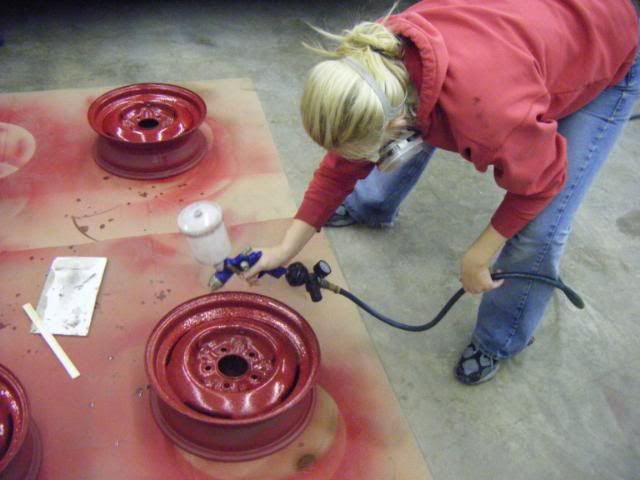

The first thing I did to them was spray can primer them with some self etching primer. I love that stuff…
After I did it though the thought crossed my mind that maybe I shouldn’t have rattle can primered them since I planned to use ‘real’ paint for the next few steps. Everything turned out just fine though in the end. I guess it is something to consider when primering or painting anything….
The ultimate goal for them was to be metalflaked. I have been pouring over Roth metalflake charts for weeks trying to decide what color, what size flake, what shape flake, yadda yadda yadda. I hadn’t even really decided when I went to Alex Gambino’s booth at the GNRS. It was time for a decision. I chose….
Rothrageous Red!
It is a smaller size flake which is what I wanted since I had never shot flake before and wasn’t quite sure how my gun would handle it or how the clear would carry it or anything else.
So I went down to my local paint store, Pavey’s, to pick out a basecoat color that was a comparable color of the flake. The guys at the paint store got a real kick out of my project. They said no one had asked about metal flaking anything for about 25 years! The guy that owns it told me that he would talk people out of it at even the mention of it but he could see that wasn’t going to work with me!
I ended up getting a darker shade of red.
The more basecoat I painted the more excited I got with the thought I would soon be doing my first flake job!
All in all they turned out well (no runs-whew!)

Now it was time for the fun part! Like I said earlier, I had never shot any flake before so I really didn’t know what to use, how to mix it, how it was going to stand up, how long between coats, nothing. I am VERY thankful for the advice I got from Alex Gambino when I bought and lowandslow (Donnie) here on the HAMB. These two were lifesavers!
So after work Friday night I got right down to business. I mixed up some clear, threw in some flake in and went to work.
The whole process was a learning experience. I really didn’t know how much flake to put in and I guess there really isn’t a measurement. It all depends what look you are going for. I was going for flake city!
I followed Alex and Donnie’s instructions and kept laying layer after layer of flake until I was happy with the amount. The first few layers were pretty light. I was a little conservative with the flake. Then I accidentally dumped too much in and it ended up being one of those good accidents because then the rims really started to look awesome. I’m not really sure of how many layers of flake I laid but I am sure it was a lot. It took me awhile (and an accident) to really get a grip on how much to put in the clear, how much was coming out, how fast, etc. One I was satisfied with the amount of flake I put two coats of straight clear on them.
Here is the end result (I also learned flake is hard to take pictures of…)

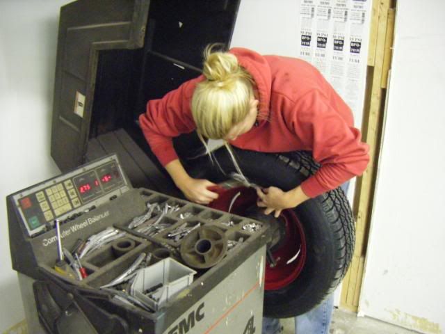

I was uber worried about screwing them up mounting the tires so I let them sit all day Sunday and most of the day Monday to dry. Monday night I couldn’t wait to see how my new tires looked on the rims.
I bought four new tires from Coker since I had sold the old ones on the rims (and they weren’t any good anymore and they were GIANT). I got the stock size in BF Goodrich
Fortunately I have access to a tire mounting machine and balancer so I was able to do it myself and be EXTRA careful.
And finally, the finished product!

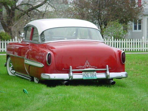

This car has become an addiction to me as of late so I couldn’t just be happy leaving her like that for the night, time to lower it!
I had already kind of hatched out a plan when I put the springs back to stock height a couple weeks ago on how low I wanted to go so I took some quick measurements of how it sat stock. I then unbolted the U-bolts and used the jack to gauge a 4” drop which is what I have planned. A friend of mine has a machine shop and is milling me up some blocks as I type this. Keep in mind I have skirts I plan to put on as well. Here is how she sits lowered 4”
And my favorite picture
I love the way it looks. It is completely the look I was going for BUT I am kind of worried about clearance issues. Here are a couple shots of the rear end and the axle. As you can see in the pics the snubbers are on the axle (I know, they can be cut) and at my best measurement abilities I think I have 3-3 ½ “ between the top of the rear end and the floorpan of the car.
So, my question is, is that TOO close? Do I need more room for travel? As I mentioned in my earlier post, I really don’t want to have to start chopping the car up and c-notching it and stuff.
My plan right now is to put the blocks in and try it. If it rides like crap I will cut them down to 3”. What do you guys think I should do?

To answer your question, I think you are a bit too low for a lot of driving situations. I hate to say that, but that pumpkin is going to get beat up and that isn't good.

It's gonna ride rough, but it sure looks good sitting like that! You might be able to gain a little travel by clearancing the trunk if the pumpkin is hitting (usually does before it'll hit the frame).

On a 53 you can really ony go about 4 inches lower than stock before the drive shaft or torque tube starts hitting the floors and the car is basicly riding on the bumpstops. Anymore than that and you are getting into cutting things up. My 53 has 3 inch blocks and worn out leaf springs and it is as low as it will go. No suspension travel, no ride quality at all.

That aside, I agree with the fellas... It's hard to get those early chevys low without really hindering the ride. However, rear c-notches are not too bad to do in those cars.

I love the look of the car that low, but it will hit hard. I have a 54 with 2 1/2 in blocks and if I hit a bump in the road you can really feel it. You should flake the steering wheel to keep the look going. I did that for a club member and it is the same color you are using. You will have a lot of fun with that car.
