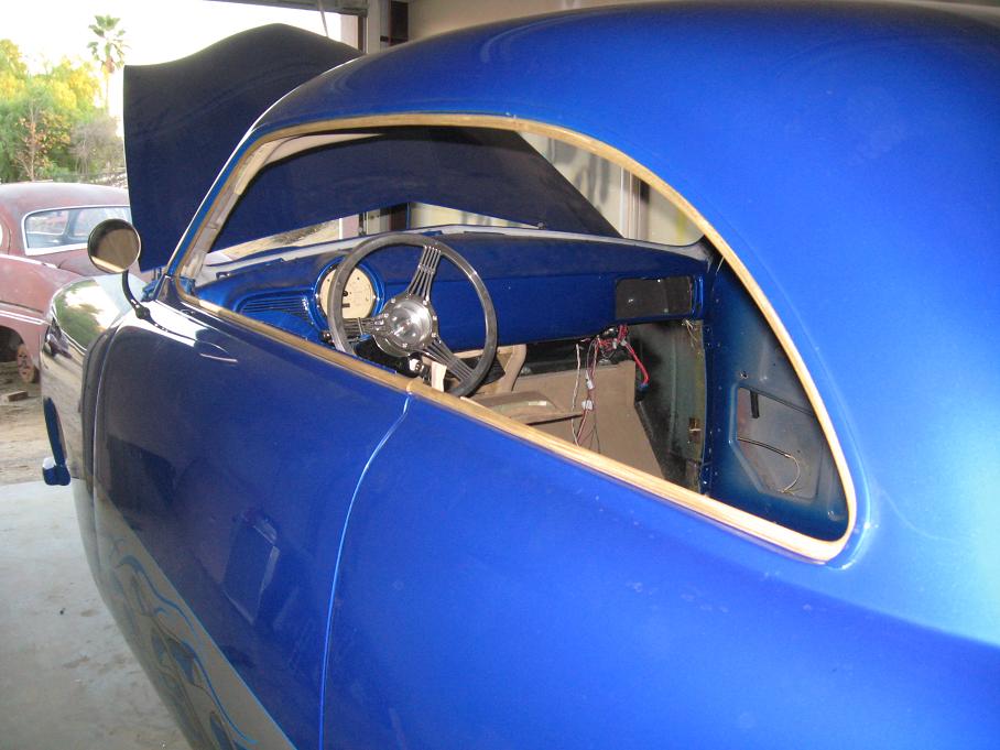

Old 01-31-2008, 09:11 PM   #20
slddnmatt
Old School HAMBer
slddnmatt's Avatar
Join Date: Mar 2006
Location: riverside ca.
Posts: 3,232
Default Re: Custom Stainless
ya thin stainless isn t to fun to play with. Flamedabone you might want to do what i have done, and doing for a couple more mercs pretty soon, i fab new trim out of brass and have it plated. it is time consuming but nice results. had a few guys ask me to do a tech on it so im trying to get some pics together here shortly.
