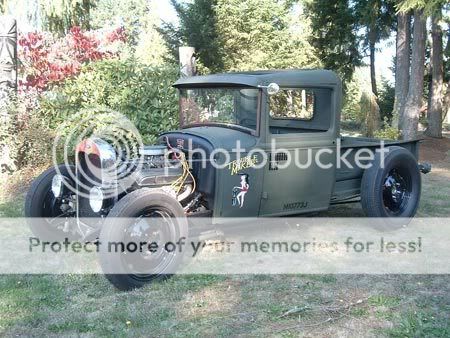

    Run the 18's! I built this Essex C-dan the same winter Brock built that Model A coupe above. The 18's look SO GOOD rolling down the road. Its the "Cartoon look" That builders try to get but miss so often...

    here are the 17"s and 18"s i am using on my truck.the fronts are 450-17,and 700-18 on the rear.the front wheels are 17x3.5,and the rears are 18x3.5 that i widened to 5".hope this helps.
    -danny
