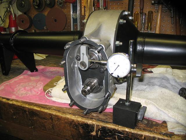

The side bell preload and pinion backlash, is set much like the stock early Ford rear end, only you are using shims on either side of the carrier, instead of gaskets, between the side bells.
The pinion is factory installed in the case, and it's pre-load is set a 20 in.lb. Therefore, you do not need to mess with that.

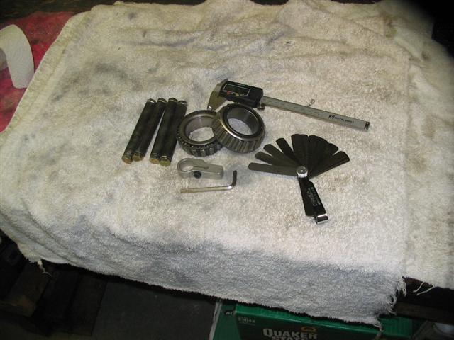

You will need a set of "set-up bearings", so I bought another set of 25592 Timken carrier bearings, and a new set of 25522 Timken cups, which I installed in the side bells. I had the 25592 carrier bearings honed out so they would just slide on and off the carrier, making the set-up easier. Pic. # 1
Side bell preload with the Wedge lock carrier installed, should be .007.
This is done by adding shims and the spacer, between the bearings and the carrier, so there is absolutely no side movement of the carrier, when the center section is bolted up to the side bells. The .007 is added to the total for the pre-load. I found this impossible to do, without being able to get a feller gauge between the carrier and the carrier bearings, with the assembly bolted together.

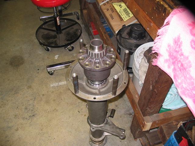

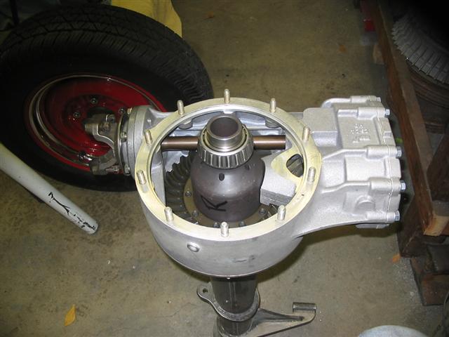

I machined four spacers the exact length of the center section, out of 5/8" DOM tubing and threaded them 3/8-24, on both ends, to space the side bells apart, the same distance as the center section, with the carrier, shims, spacer, and bearings installed. Pic.# 2.
Stand the left housing on the ground, and assemble the carrier and shim pack with bearings, and then bolt the right side housing together, lift it up on the bench for your measurements.Pic#3.
Do not bolt the Ring Gear to the carrier yet, as it is much easier to measure for the required number of shims without it in place. Double check, that the carrier is tight, and has absolutely no side play between the side bells, then add the .007 for your carrier pre-load.

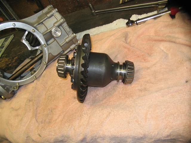

Once you have the carrier pre load established, you can bolt the ring gear to the carrier, taking care to position it correctly, and torque to 60 ft. lbs. in steps, using Red Locktite and the supplied Belleville washers and bolts. Pic#4.

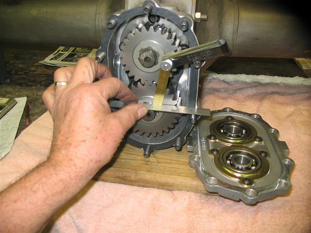

To set the Pinion backlash, start with an excessive amount of shims on the backlash side (right side) of the carrier. This is to prevent a false pre-load reading. A false pre-load reading will occur if the ring & pinion are crushed against each other.
Again, this is easiest to do if you stand the left housing on the ground, insert the carrier, the centre section, and then install the right side housing, bolt it together and then place on your bench to do your checking. Pic#5.
Winters supplies shims in the following thickness, .007, .010, .012, & .016.
These are some of the combinations you are likely to use. Pic#6.
You should take notes of the combinations you are using. Pic#7 & 12.
Move shims from the right side to the left side, until a back lash of .004 to .008 with no tight spots is achieved, measured at the upper change gear pinion, without the change gears in place. Pic#10.

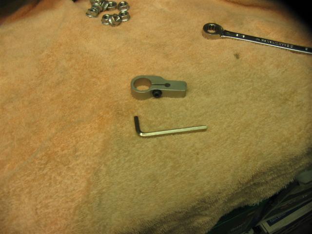

I made a small clamp to assist in this. Pic#11.

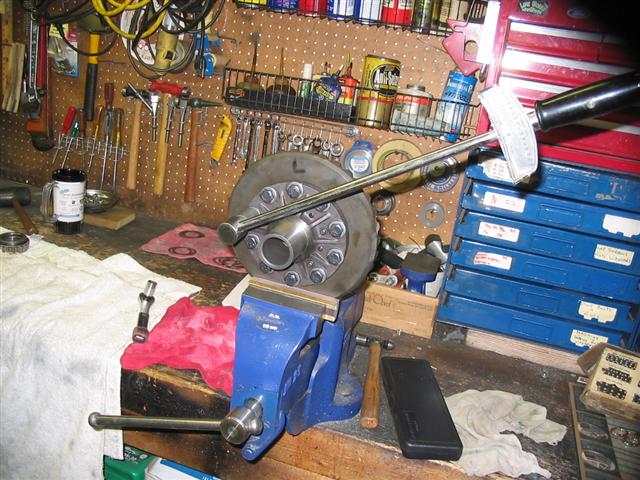

The total preload of the assembled assembly should be 27 to 29 in.lbs. measured with a beam or dial style, torque wrench.
After completing this set-up, it occurred to me that with the thousands of these units produced, and the precision CNC equipment that machines them, the final set up would probably be pretty much the same, on all of them.
My final set up was, .100 to eliminate any side play, plus .007 for the preload, for .107 total. In my final set up, the split was, .050 on the left side of the carrier, and .057 on the right side of the carrier. In addition, there is a .125 spacer on the right side of the carrier in all of these calculations. Pic#9.

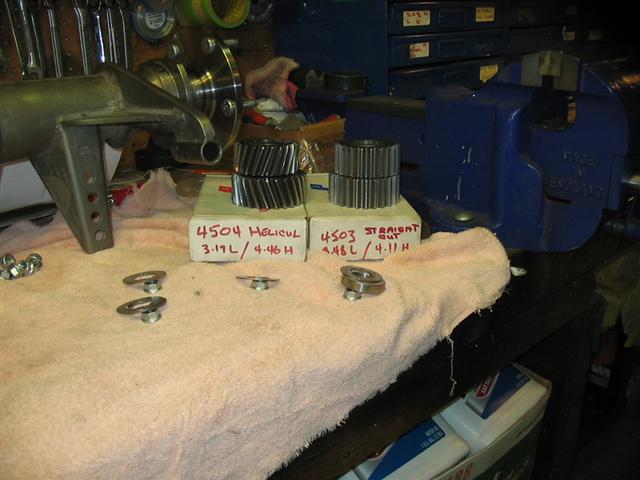

I ordered my quick change with a # 3 set of straight cut gears, and a set of # 4 helical gears, which should be shimmed to .005 to .010. Pic#15 & # 16.
No sense having a Quick change, with out changing gears occasionally, or when the straight cut's start to get on your nerves.

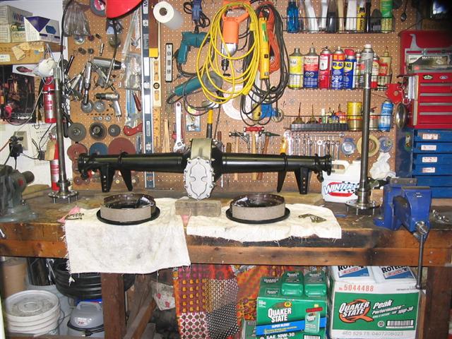

Measure for axels to the centre of the carrier, parting line inside, and deduct 1/8". Pic# 18.
Then add your axels and brakes.

Another interesting thing that I discovered about using the Winters V8 Quick change in a 32 Ford, is you do not have to notch the gas tank for clearance.
The Winters V8 unit is 3 1/2" from the side bell flange to the rear cover, and the Halibrand is 4 1/2" for the same measurement. All other dimensions appear to be the same.
HemiDeuce.

Default Re: TECH: How to set-up a Winters V8 Quick-Change
This is my take on setting up the carrier crush on this rear end.
First you are going to have to make some kind of vertical holding attachment to support the axle assembly on a work bench or engine stand.
If you are using original style bells you must use a paper gasket to prevent the joint from leaking. I use the .005 gasket as a seal on each side.
It is a good idea to have a set of set up bearings and you can actually use a good set of used bearings if you want to. Just hone out the center so the bearing slides over the carrier snout as already outlined.
Now this is a two part task, setting the carrier crush and setting the pinion back lash, first the crush.
To begin to set the crush, you should remove the ring gear from the carrier, it is not absolutely necessary but by removing the gear it eliminates the pinion drag and a more accurate feel is accomplished.
Position the left axle tube vertically, drop on a banjo gasket, install the set up bearing using the medium thickness spacer, then the carrier, then install the QC case to the lower banjo tube and fasten with 4 bolts in a square pattern.
Now position a gasket on the right tube using a light film of grease to hold it in place, install the opposite side set up bearing and the medium spacer, Carefully install the right tube. This tube should not set flat upon the QC case. If it does remove the tube and the center section and replace the bearing spacers with the next thickness larger and reassemble the unit. At this time the right tube should not set tightly upon the QC case.
With the upper bell setting squarely on the QC take a feeler gauge and measure the distance on each side of the upper bell flange to the QC case surface to determine the distance required for the proper bearing crush. If the spec's say it is .007 and your gauge measures .007 then you are good to go. If not this is where the hard part starts.
Since the carrier should be somewhat evenly spaced between the cones it is necessary to balance the shim stack on the carrier bearings. EXAMPLE: Should your feeler gauge read .015 this would mean that the carrier bearing shim stack is to LARGE and must be thinner. Since you need .007 crush, you would determine the amount of shim to be removed by subtracting .007 from .015 equaling .008 and divide this by 2 to balance the spacing per side giving a difference of .004 spacing that must be removed from each carrier shim to achieve the correct crush. At this time you would disassemble your unit and adjust the thickness of the carrier bearing spacers as necessary evenly reducing the spacer thickness on both sides to achieve the determined crush clearance. Reassemble and recheck your clearance again.
After establishing the correct crush the next step is to check the ring gear back lash.
Remove the QC case and carrier from the left tube and reinstall the ring gear on the carrier remembering to torque the bolts correctly. Reassemble the unit and this time install 4 bolts in a square pattern on the upper tube also and tighten. This establishes the positioning to determine the pinion back lash. With the QC gear cover removed attempt to rock the pinion shaft back and forth on the ring gear, if it does not rock there is no pinion clearance, if the pinion rocks a lot there is too much pinion clearance. The correct amount of rock can be determined by using a dial indicator and you should have between .008 and .011" of movement.
If you have no movement the ring gear is binding with the pinion and must be adjusted further away. To do this requires that the carrier bearing shims be adjusted from side to side to insure that the spacing of the crush remains the same but the relationship of the gears changes. In the case of being to tight the ring gear must be moved away from the pinion so this requires the cone bearing spacer to be made thinner so you would exchange the left cone bearing spacer for a thinner spacer and add the same amount of difference to the right side cone bearing spacer. Say you had equal .010 spacers on each cone to achieve a movement of .005 out you would replace the left cone spacer with a .005 spacer and the right cone spacer would be increased to .015. This would retain the same crush spacing but move the ring gear away from the pinion to achieve the correct amount of back lash. The reverse is applied if you have too much back lash, you would add spacing to the left side carrier bearing and remove spacing from the right side carrier bearing moving the gear closer to the pinion and reducing the back lash.
Now this takes a couple tries so you should not be using any sealers or attempt to bolt this tight the first time, it may require two or three checks to get each of the components aligned correctly.
Once you are satisfied that you have all the clearances correct you can disassemble the unit and install the new carrier bearings apply a tin coat of gasket cement on the banjo gaskets, reassemble the unit and torque the nuts.
Hope this helps you out.
