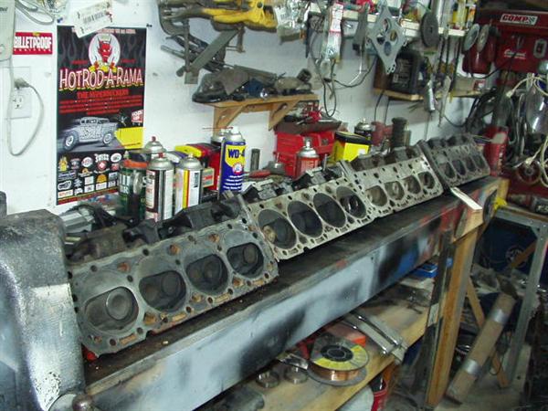

here are a few that have I have been working with as of late.....
Attachment 204043

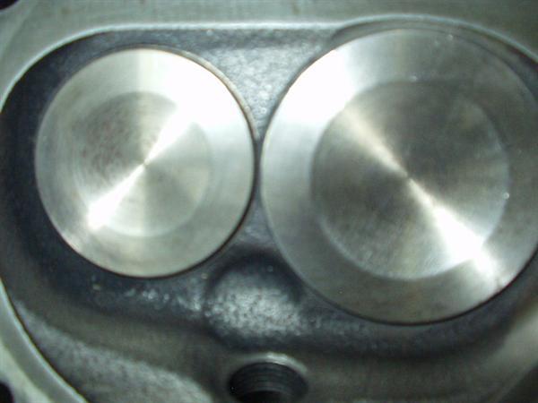

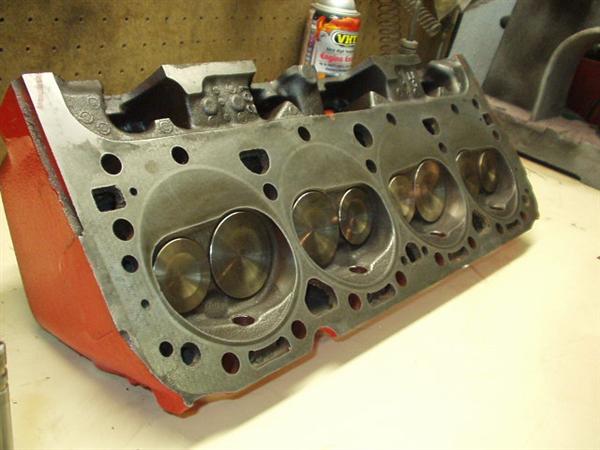

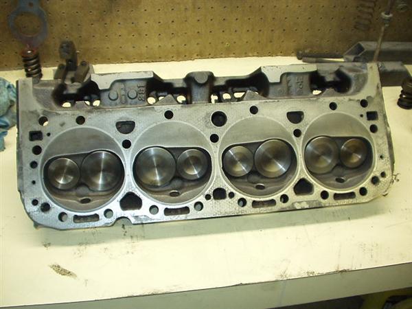

the first thing I look at when I go to look at a set is what size valves do they have?....they will have either a 1.94/1.5 or a 2.02/1.6 valve set....either factory or machined afterward....a lot of the 1.94's that have had multiple or bad valve grinds, end up gettin cut bigger for the 2.02. in some very rare instances where a drag racer has had them, they could have a 2.05 intake, but it will be very rare to see this
the 1.94/ 1.5 will have a definite area between the valves that you can plainly see
Attachment 204044

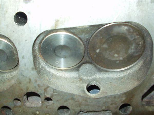

the 2.02/1.6 will look like the valves are touching....virtually no area visible between them.....when you see this you know that you have the big valves
Attachment 204045

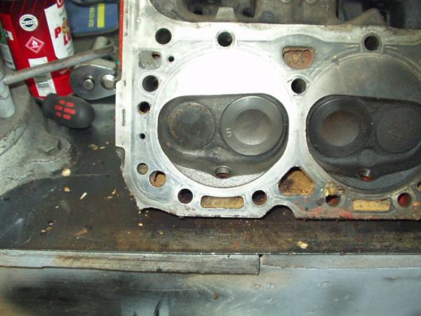

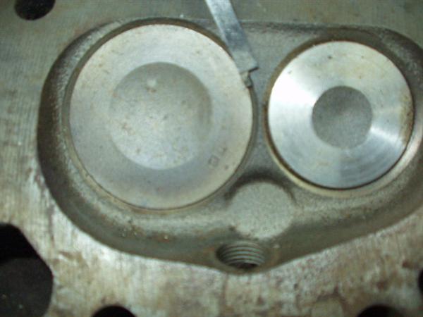

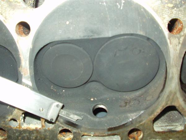

the next thing to look at is what shape the valves and seats are in
if the valves are sunken down into the valve seats, they have either been ground to much or to deep , or have pounded the seats down......the problem with sunken seats , are that they create all different valve stem heights.....especially if someone has been over agressive with the valve
grinder..

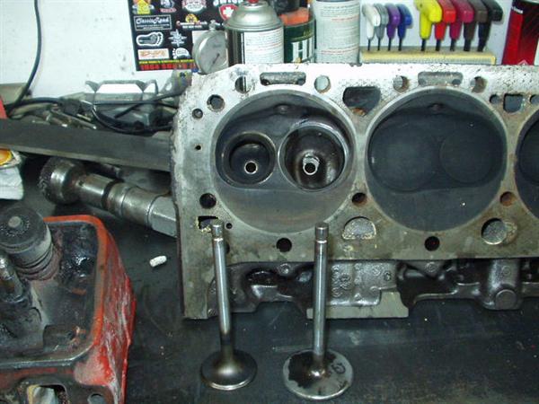

here is an example of sunken valves and then using a straight edge on the valve stem you can see the difference in the heights
Attachment 204046 Attachment 204047
what you would like to see are the valves sitting up, where you can actually see the valve edge or margin above the seat area.
Attachment 204053

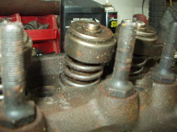

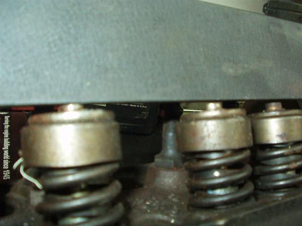

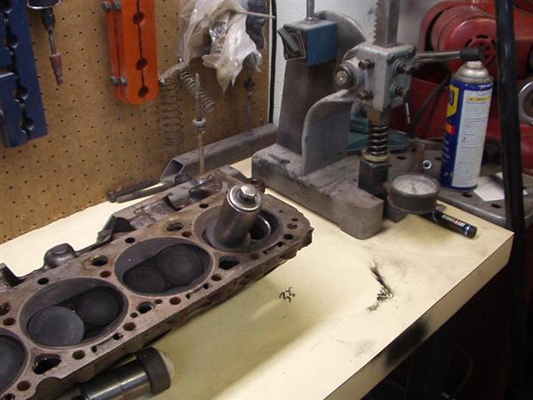

next I look at the valve springs, have they been modified? and to what extent.
a stock set up will have cast iron guides and valve springs with oil shields installed. they should have a small O ring style valve stem seal on the valve stem.......the oil shield is to help control the amount of oil the the O ring has to deal with...insureing enough oil gets to the valve guide ,but not to much
the springs will look like this
Attachment 204054
most times when a valve job is done the valve guides are changed to either a thin bronze liner or a new thick wall bronze guide is installed.... a lot of times a positive type valve stem seal is installed when this is done...I do not like to see the positive type seal used if the stock oil shields are gonna be reused, you are not going to get the proper amount of oil to the valve guide by using this combination
Attachment 204055
if you are gonna use the postive type seal you should go to an after market retainer at least.
Attachment 204056

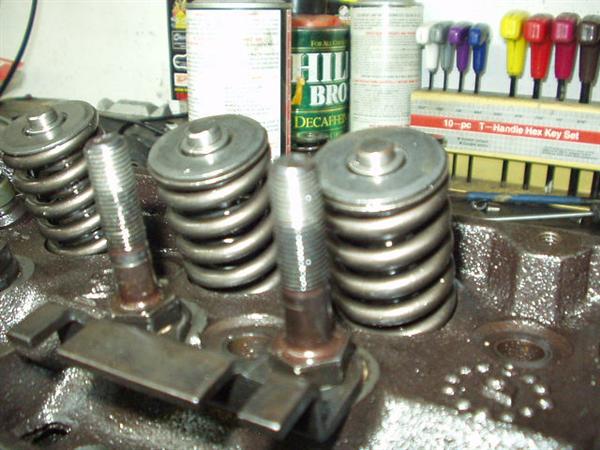

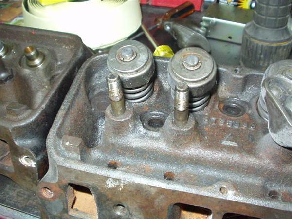

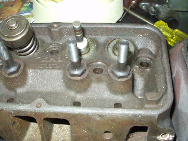

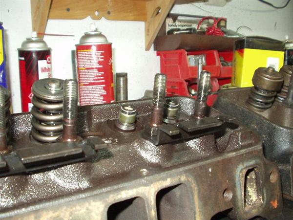

next thing to look at is the rocker stud set up . It will be stock pressed in stud.....
pressed in stud that has been pinned......
tapped for a screw in stud......
.tapped and machined for a guide plate and screw in stud. I dont have any pictures of pinned studs....it really isn't done much any more...the first pic is a pressed in stud. You can see the boss the stud sits on is tapered at the top.
in the next pic you can see where the boss has been machined to flatten it off and give a little more surface area then drilled and tapped
finally the last pic you can see the boss has been milled down to accept the thickness of the guide plate and screw in stud.
Attachment 204061 Attachment 204062 Attachment 204063
it's nice to at least have the screw in stud for a performance application.

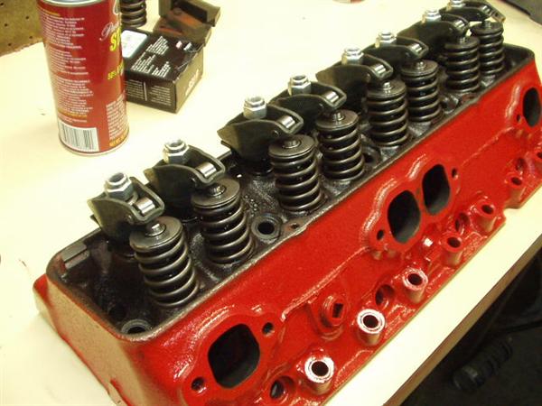

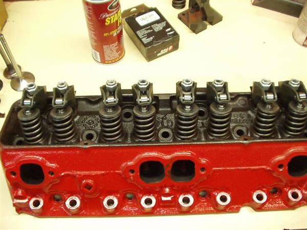

I picked up this set of 291's the other day,, they had the 2.02 valves and the chambers had been unshrouded....they had fresh comp cam springs and retainers and had also been cut for screw in studs and plates
Attachment 204068
Attachment 204069
Attachment 204070
I diassembled them and checked them over...they had hardened exhaust seats and everything looked good, spring heights are even, studs are machined straight.
the fellow I bought them from had took them off his 383 stroker, they just were not enough head for it.he gave me the name of the machine shop that had done the work, everything looked good so I brought them home and opened them up, checked the seat runout, guides etc
they have had a little pocket porting done,valves unshrouded, everything looked good so a little elbow grease and I had them cleaned up, these prolly have 4 or 5 hrs run time at most , and are everything the seller said they were.
Attachment 204071 Attachment 204072 Attachment 204073
after checking spring pressures and valve seats, a little more cleanup I shot them with a little chevy orange VHT
Attachment 204074
they started to look so good I rolled them over and installed the Glenn Hayes/Federal Mogul sponsored roller tip rocker arms.....
and there you have it . the 2006 HAMB DRAGS raffle engine heads
291 casting
2.02/1.6 stainless valves
pc seals
comp springs/ retainers/ locks
bronze valve guides
screw in studs
guide plates
pocket ported
roller tip rockers
these things cost us less than ONE vortec head, and this is not a rare deal , but i believe the 4th set that I have picked up this year, and a couple I passed on at the last swap, cause I just didnt need them...., oh I have walked by some junk to find them but keep your eyes and ears open and I am sure you will run across a set just as nice.
Attachment 204074 Attachment 204075 Attachment 204076

Fred, do you mind explaining shrouding and how to remedy this?

basically the edge of the valve is extremley close to the combustion chamber wall, the intake charge is restricted and cannot flow around the head of the valve. by machining the combustion chamber wall away from the valve .,..you open up some area for the intake charge to flow...this is a VERY basic explanation
here you can see the shiny area where the chamber wall has been machined away
Attachment 204410

many e mails on the difference between the 461 and the 462
the 461 was the original camel hump, it had a spark plug location very close to the edge of the combustion chamber....also the combustion chamber had a little different shape than the D shape of the 462
the 462 and pretty much all the following camel hump heads had the D shaped chamber, and the spark plug location was moved with a large quench pad adjacent to it....these are the heads to use if you are going to run domed pistons, the 461's usually have some interference with domes and spark plugs.
461
Attachment 204412
462
Attachment 204413
Click image for larger version
Name:	camel hump 004.jpg
ID:	334071   Click image for larger version
Name:	camel hump 003.jpg
