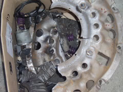

  17. In this box are the remains of DE SOTO's pressure plate that let go in his 6x2 De Soto Hemi powered sport coupe. Happened in front of his house and shrapnel punctured the enclosed trailer sitting on his neighbors driveway! Check the second pic closely and you can see some of the damage done to the cowl. I'm hoping Rick will get on here and tell us the rest of the story.

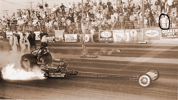

    The most famous explosion, which ended slingshots. The circled kid evidently lost an arm from the shrapnel, some of which is flying across the other lane.

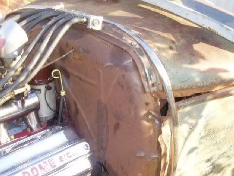

    YUP, THAT WHAT WAS LEFT OF THE CLUTCH IN MY SPORT COUPE !
    Happened right in front of the house, at about 1/2 clutch release i rolled on the gas hard and .... !! BAM !! & a very hard jolt.
    Stuck the engine at full throttle, Hit the mag kill switch and the brakes , HOLY SHIT !! No brakes !!!!
    Went to turn in the neighbors driveway, SHIT AGAIN !! No steering !
    Flung open the door to drag my foot to stop it ( sounded good at the time ) and relized the damn thing was doing about 20mph .... dont sound like alot, but after all that it was HAULING ASS !
    Lucky for me, a bunch of guys were in the street playing B~Ball and were able to get the car stopped before i went accross the cross street, over a curb, thru a fence & into a guys front yard.
    Wiped everything off the inside of the firewall right from under my foot, smashed the steering box, cut the brake lines & oil gauge line, flying parts bent a wishbone, destroyed the firewall & bent up the cowl some, flywheel, clutch, bell housing & related parts destroyed, and im sure other parts i dont remember.
    One real scary part is i never found all the parts for the pressure plate.
    Parts hit the neighbors trailer, the front of my '61 Dodge, another guys Nash that was here.
    I'll tell ya, this happens REAL FAST !! Dont let it fool you, like 1/1000 of a second fast......
    If it were to cut off my foot, I woulda not known till i tried to get out of the car ... puts you in a state of shock for a bit.

    Is this really true? I never knew that a spectator lost an arm in that famous Garlits clutch explosion. That's terrible. Quite the photo by the way. I've never seen that view before with the shrapnel going through the air.
