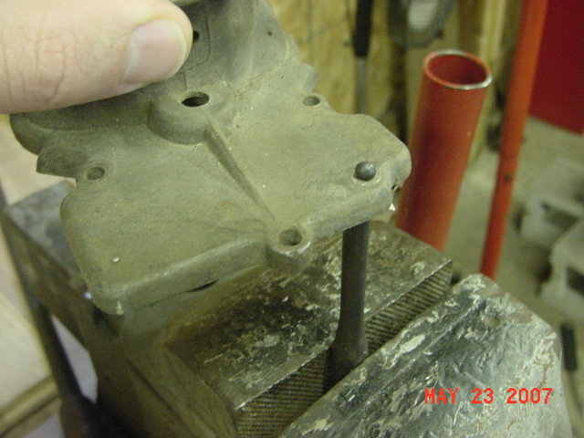

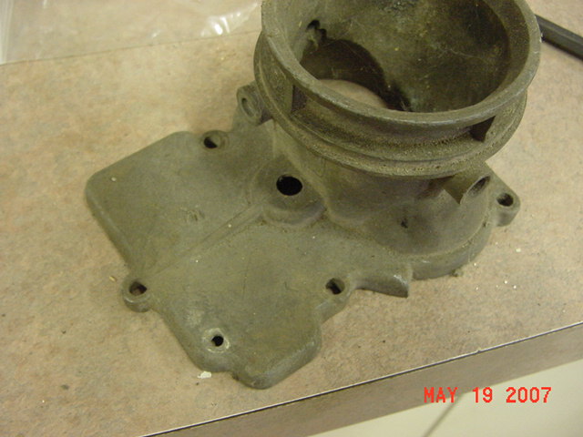

    Several of my old 97's had holes drilled in the top air horn. I knew that people did that to run the old gasoline heaters in their ole' Fords. I had a couple fellas say, "Ah, just run a sheet metal screw into the hole and that'll fix it!" Well, I don't particularly like the looks of a shiny hex headed screw sticking out of the top of my 97. I mean, come on, these things are legends. One of these will make a flatty pretty cool but adding more than one will make a flatty crazy cool!
    So, I was messing around with my Stromberg parts and happened across some little, what looked like, lead balls. Just about the right size to swag down into the hole in the air horn.
    As you can see, this is nothing fancy but it does "fix" the problem and retain an almost original look. I have had this carb on a running engine for over a year and it has never leaked (except in the usual places). Next time I do this, I'll glass bead the whole carb, including the repaired area. I think it will help it to blend in the color even more so.
    The little lead ball came from (jump in here and help me) a check valve in the 97. I happen to have some extras. I did notice, however, that some have a steel ball and some have the lead ball.
    I simply took a drift punch and placed it in a vise. Then I centered the air horn over the punch so that the drift punch was used as a backing device- so as to not warp the air horn. I used a nice ball peen hammer to hammer the lead ball into the hole and to try and smooit out. I should probably take a file to it but I wanted to leave the excess on it to be sure it doesn't leak.
    There you have it, save those 97 air horns.....

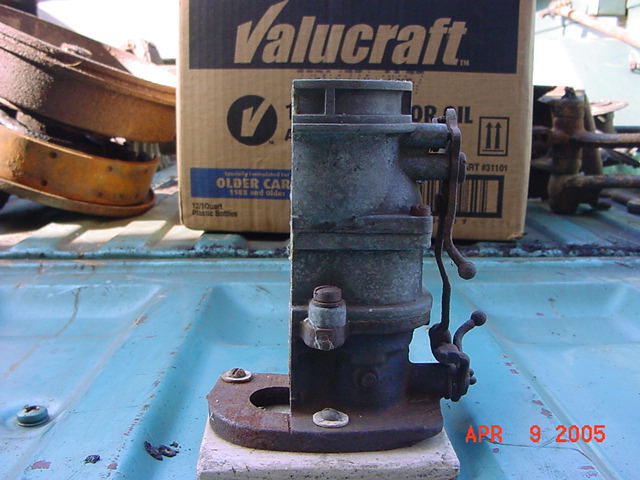

    Here's the finished product....sorry the pics are crappy.......
    Like I said, on the next one I do, I'll try glass beading it after i swag the ball in the hole and dress it down further with a fine file....
    EDIT: the one in this pic, someone drilled the hole in the other side of the float bowl......the pic up above (as you can tell) is just another air horn i had laying around and they drilled the hole in a different location...

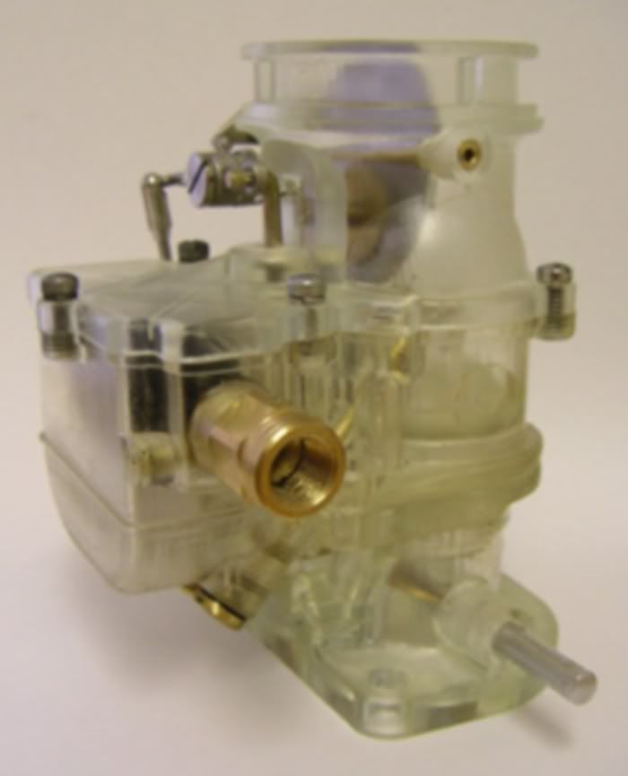

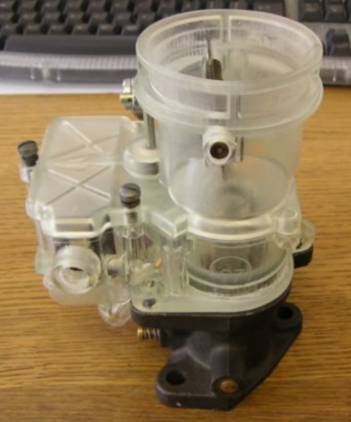

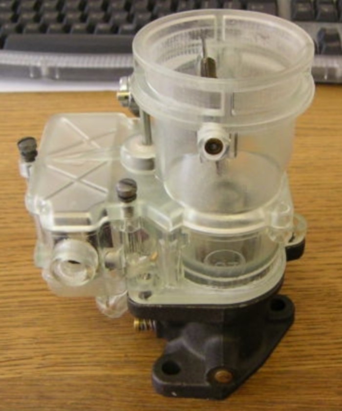

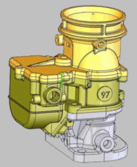

    That's not a plastic contraption as per say, Mr Corn Fed and Mr Nukegm recognized what the resin 97 is.
    SLA or Stereolithography is a prototyping process that produces a solid 3-dimensional object from a computer 3D CAD file.
    The 3-D Cad File controls a motorized laser that basically heats/cures the object as it descends one slice at a time into the vat of liquid photopolymer or resin. Photpolymer is similar to film for a 35mm camera in that light imprints or cures the image.
    The laser beam will not penetrate down into the vat of liquid photopolymer but it will 'cure' the very top surface or 'film' of the liquid vat.
    The Laser follows the 3d cad design exactly and very accurately from a 90 degree position over top of the vat. The object is 'burnt' one layer at a time as the layer traces the cad file.
    The layers can be described as similar to a deck of cards... Once one layer is 'Burnt/Cured', the object is lowered a few thousands of an inch and the object is again covered by liquid resin. The laser then 'burns' or cures the next dimensional slice on top of the slightly submerged object.
    Once the object has fully descended into the vat and the laser has cured it's last 'slice', the object is carefully raised from the tank and emptied of any liquid resin then it's off to the infared oven for final hardening and cureing.
    The resins for this process are about $800 per gallon which translates to fairly expensive prototyping.
    These images were sent to me by Clive Prew in June of 2004 while he was still in the development stage of what would soon become the all new Stromberg 97's.
    It was mentioned at the time that the original complete Laser built 97 (as pictured) exceeded many, many thousands of dollars as a prototype. That did not include any prior research or the programing and mapping of the Cad file. Clive is not interested in selling or giving away the delicate Prototype but he was willing to send me some early prototype pics which you see now.
    The New 97s have been out for several years so there is no danger of giving away any patented or prototype 'trade' secrets. I thought I would share these neat pics with you guys. I do know that these prototype pics were emailed to the cad design team as well as myself in the spring of 2004. I believe that these two images in particular have not been posted anywhere on the www before. The above images are also fairly low res compared to the originals (for obvious reasons). Clive still holds the copyrights to the 3D CAD design that made this SLA Resin Prototype and the subsequent new Stromberg 97's.
    It is interesting to note that this resin carb should actually be capable of metering fluid and air into a proportional and accurate "fuel to air" ratio. The SLA process is accurate to .003 inches so even the threads of a small screw hole are accurate to the original item which was scanned into the cad file by a laser beam.
    The pics were taken on the day that Clive returned to his office with the prototype freshly cured and out of the oven. Clive was in the midst of carefully assembling the delicate Stromberg 97 with the appropriate hardware/fittings/screws/parts that would eventually be used on the forthcoming -all new- Stromberg 97's.

    Bringin this thread back from the dead here. I have a few holes drilled in my 97's also, and I was wondering if these can be welded in? anyone have any experience with this?

    If you want to fill a hole in an aluminum part... drill a hole, put in a piece of aluminum rod and peen it over. Then file and sand flat. You can polish the part and won't see the repair.
    First time I saw this done, was an old English motorcycle side cover with a hole in it. I was amazed how easy it was, and how perfect the finished part looked.

    I think these holes were for the feed for a Southwind Heater
  21. Might try small lead fishing clinch sinkers. They're round, sort of.
