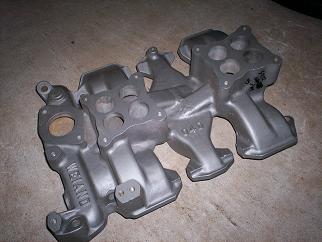

Default Intakes: stock intakes and aftermarket intakes aswell as blower intakes & injector...
Fuel injection
Hilborn:
made several for olds, atleast 3, 303, 371 and 394 to my knowledge
these could ether be dist driven or camshaftdriven by using an timing cover..
or driven by fan belt , belive there was an beltdrive part to put on the same
pump that would go on an timing cover.
Supercharger - blower intakes , crank pulley and all parts surrounding
cragar:
cragar made as far as i know 4:71 intakes + 6:71 intakes
i belive 471 cragar intake came with and without water passage in front
(as seen in pic below)
i've seen on ebay quite often that cadilliac 471 intakes are misstaken
as oldsintakes, so beware, but on the otherhand cadillac cragar intakes
bring a little more money so in worst case you just can flip it and earn something from it incase you bought the wrong item...
Weiand:
1949-1956 - 303-324 - for 6:71
1957-1958 - 371 - for 6:71
1959-1964 - 371*-394 - for 6:71
Supercharger - blower brackets
Mcculloch supercharger bracket
Mcculloch made an bracket to put the vs-57 supercharger (the one studebakers and kaisers used), on an stock or aftermarket intake, it will basicly mount
on all intakes that has the generator holes on the driverside, but might not clear
for instance 3x2 edelbrock intake, i have an such bracket and and a couple of ol-396 edelbrock intakes, but i do not have an supercharger but seems supercharger would interfeer with first carb, but will of course work on stock intakes,
with either airbox or xxxxxx.....
i got some old mcculloch parts manual that i will scan and add here asap.
more info to follow
also needed is a crank pulley...
Carburator intakes
edelbrock:
1949-1956 - 303-324 - ol-396 - 3x2 for stromberg carbs
1949-1956 - 303-324 - ol-396 - 3x2 for rochester carbs, same part number but seem to be a different casting, only seen one once on ebay on pic.. where you mount carbs look diffrent then the one u use stromberg carbs with
1949-1956 - 303-324 - ol-496 - 4x2 for stromberg carbs
1959-1964 - 371*-394 - o263 - 2x4
1959-1964 - 371*-394 - O96 ML - 6x2 for stromberg carbs, note intake has no water provision, need "external"
Edmunds:
1949-1953 - 303 - 2x2 intake
Horne:
1949-1954 - 303 - 4x2 - stromberg intake
offenhauser:
digging into the earlier 180 degree intakes also...
1949-1953 - 303 - 3200 - 2x4 - 360 degree ? no heat
1954-1956 - 324 - 4060 - 3x2 - 360 degree ? for rochesters
1954-1956 - 324 - 5257-TP - 3x2 - rochester
1954-1956 - 324 - 5257 - 3x2 - large base rochester
1957-1958 - 371 - 4061 - 3x2 - 360 degree ? for rochesters
1957-1958 - 371 - 5258-TP - 3x2 - rochester
1957-1958 - 371 - 5258 - 3x2 - large base rochester
1959-1964 - 371*-394 - 5183 - 2x4 - 360 degree ?
1959-1964 - 371*-394 - 5606 - 2x4 - quadrajet low rise
1959-1964 - 371*-394 - 5753 - 2x4 - quadrajet high rise
1959-1964 - 371*-394 - 5259-TP - 3x2 - rochester
1959-1964 - 371*-394 - 5259 - 3x2 - large base rochester
Gaskets:
offenhauser:
1949-1953 - 303 - 3312
1954-1956 - 324 - 3313
1957-1958 - 371 - 3931
1959-1964 - 371*-394 - 5211
* notes small bore 394 with 371 cui, not same as 1957-1958 block
My supercharger setup for my 394 olds rocket engine
http://public.fotki.com/oldsrocket/s...-471-intake-a/
more pictures (thanx royalcrown32)
edelbrock ol-396 3x2 intake
Edmunds 303 2x2 rochester style intake with edmunds aircleaners (thanx to hat man)
horne 303 intake
early 180 degree 303 intake?

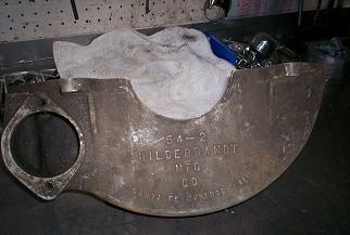

Default Transmissions: adapters, bellhousings, flywheels, clutches, shifters etc
Note on transmissions, i will ONLY include all lasalle transmission, the "buick" style selector 1951+ manual, hydramatics + 1953 dynaflow,
there is adapters to use "1939" ford trannys aswell as t-10, t-5 style etc i see no need to have any indepth information regarding those transmissions except on how to mate them to the rocket...
Manual transmissions
1949: No manual transmission
1950: the only year of the side shift lasalle tranny with short tailshaft + only bellhousing from olds that works with other lasalle trannys
1951+ not same as 1950 olds, lasalle do not bolt up, same flywheel and clutch though,1951+ is a selecter type, not as bullet proof as lasalle 1951+ can use early buick tranny though, early buick trannys are almost ast bulletproof as lasalle, some parts even interchange inside them
note that cadillac 1949?, 1950,1951,1952,1953,1954 has the same bellhousing as oldsmobile, and that many ambulances aswell as funeral cars could have lasalle trannys, though is 1950 olds the ONLY year with shorty tailshaft, the 1949-1954 has the same bellhousing as 1950 olds though ( i am not 100% sure if 1954 cadillac had the manual trans, did they share infact the same flywheel as earlier olds in 1954 for manual or did they use 176 gear flywheel in 1954?, i own an 1953 cadillac tranny .. pics below)
Flywheels:
Oldsmobile 1949 - 1953 (303) - 145 teeth
Oldsmobile 1954 - 1960 (324 + 371) - 176 teeth
Oldsmobile 1961 - 1964 (late 371 + 394) - 176 teeth
Automatic trannys
1949 -
1950 -
1951 -
1952 -
1953 -
1953 - dynaflow
adapters:
offenhauser:
1949-1964 303-394 - all engines - #0301 - to 32-48 ford and 39-50 mercury and up to 1952 truck
1949-1964 - 303-394 - all engines - #5857 - olds to 3speed t-90 4wdr tranny
1949-1964 - 303-394 - all engines - #5858 - olds to 3speed toyota tranny
starter switcher
to move starter to passengerside to clear steering on hotrods.
hildebrandt:
offenhauser:
1949-1964 - 303-394 - #3605
wilcap:
pics of flywheels:
pics of transmissions etc:
this is my 1950 olds transmission with hurst shifter
this is my 1953 cadillac ambulance tranny with hurst mystery shifter
bellhousing pictures:
eelco
1950 olds bellhousing
1951 olds bellhousing
offenhauser #0304 adapter
offenhauser #3605 starter switcher

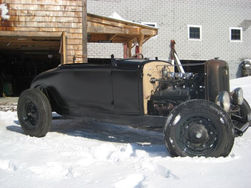

Here's a Chevy that ended up with an Old's,,lol,,,though supposedly it was the thing to do back in the day

three bells for the Olds motor to Cad Lasalle transmission
two aftermarket one stock

DAEMON i just caught this thread for the first time. WoW great thread , im finishing up my build on my blown 394 for my 37 chevy gasser. and in the process of that build i have learned the HARD way how to identify weiand WO671 intakes. In the picture you posted of yor 394 blower setup. take a close look at the intake mounting holes and you will notice they are drilled in a slightly different position in the cast in space provided in the raw casting (easy to notice on the center ones)as Weiand used the same casting for all years 49-64. (besides the diff. in pop off location) they just drilled the mounting
holes for the different years in just slightly different spots. The pic you posted (labled 394 blower setup) is of a 49-56 WO671 intake . Here is one of a 59-64 394" WO671 notice the hole location in the center. Dont be fooled by port size on these intakes most have been cut. as i stated i have learned the hard way as i own 4 of these.
weiand did stamp a number or a letter between Weiand and WO671
"56" or "A" = 54-56
"57" or "58" or "B"= 57-58
"59" or "C" = 59-64
i hope this helps the post , ill take some pics of my goodies and post em. Thanks

Hey!
ohh so i don't have an 394 blower intake afterall?
well goodthing is that i got several olds engines, 303,324,371,and 2 394's so i can use it on another engine instead
but darn in that case my plans for my 1934 coupe is alittle bit halted at the moment though .

well the one i have pictured is a extra 394 one i have . anything to trade? what is your manifold stamped number or letter?

Figured I'd showoff my parts too.
Offy 2x4 with I think '53 rochester 4gc's and
Gotha adjustable rockers
I also have a isky cam and mallory dual point dist. Does anyone know of a simple way to find the specs of a isky cam?

I have been saving this one for a looong time,... I have to get a rubber trans mount so I can finalize the brackets.

'starting to piece together another blower motor,
here's an early mockup picture of it sitting on a late 394 in the A Coupe
but the plan is to put it on a 371 in the A Roadster
that is if I can ever get out there and actually make some progress

Paul-did you fab up those motor mounts?. Looks like my work.

it looks like he has a few more kits under the car if you need one.

yeah, gotta drill and tap the block for front mounts
the wood blocks get in the way of the fuel pump and exhaust..
