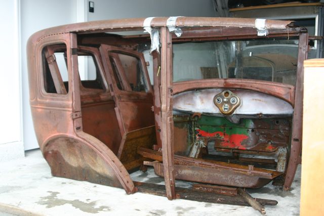

I stumbled onto Dodgerodders Fordor build a while back and really liked what I saw. Then about a week ago I saw a posting on Craigslist for a Model A. So I go and check it out and low and behold its a Fordor. So after sitting on it for a week I called the guy back up and drug this home.

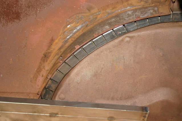

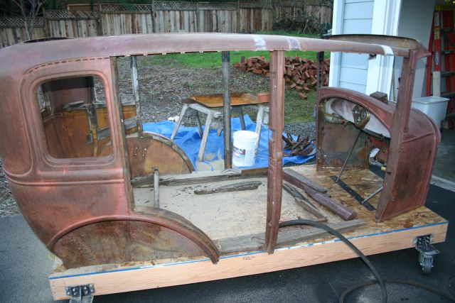

Step 1: Make base to mount body onto.

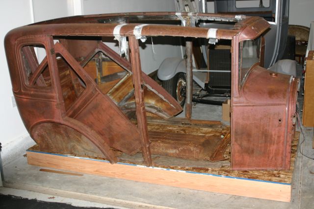

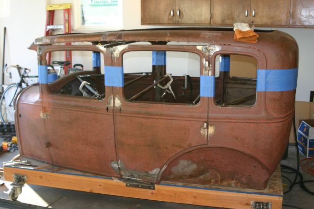

Step 2: Fixture body to base and rust removal.

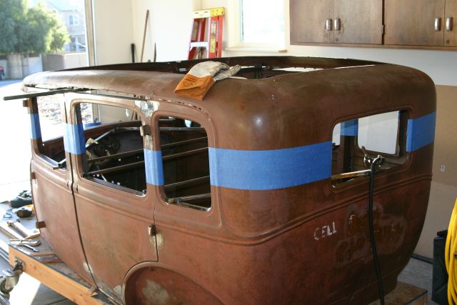

Step 3: Mark off chop and brace body.

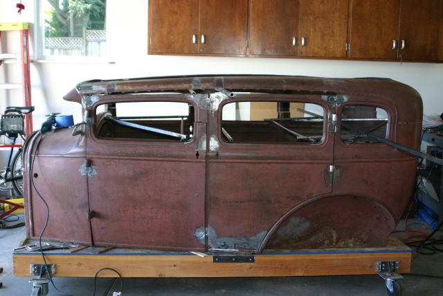

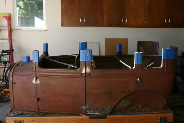

Step 4: Chop top.

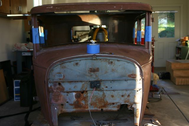

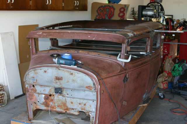

Step 5: Mock up (see how's she's looking)

This was the first chop my brother and I have ever done. Very exciting. It's amazing how much the chop changes the whole attitude of the car. We still have some work to do to get it all back together. I do have a couple of questions regarding top chops:
1. Is it common to have to touch up areas to get a good fit?
2. When you start tacking do you start at a particular point? (ie. A pillars and work your way back)
3. I've heard about pie cutting at the doors to get the posts to line up, can somebody explaing this procedure?

there is a thread on here with some really nice pics of a model-a chop, shows his pie cuts on the posts, it was a fordor, now i cant find the thread, its here i know it. ok i found it,
http://www.jalopyjournal.com/forum/s...t=model-a+chop

Hey man that looks great-brings back memories! The platform thing worked out great for me, it helped keep it all square, hopefully its working out on yours too. For what it's worth, my input on your questions:
1. It is very common(for me). I probably had the roof on & off 74 times to get the fit right, but its worth the extra effort. The better your fit-up is, the easier the welding will go and the better the end result is. The exta time you spend here will pay off in the end
2. Once I got the fit where I wanted it, I tacked the whole thing in a few places in each area(each pillar, and the back section). Once it was all tacked, and still lined up well, I finished welding, skipping around to keep it cool and minimize distortion. You must get #3 right though before you can finish the doors.....
3. This step is simple, but needed to make the posts line up. Done right, it will mean very little finish work to get it into paint. Pie cutting is needed because once you cut the section of pillar out, the bottom section will be fatter then the top section, because there is a slight taper to the door posts-they get thinner toward the top.
To fix it, all that is needed is a simple cut in the lower door post, so that you can pull it in to make it match up-SEE PIC:
Weld it up and be done with it. The first door will take the longest-once you do one, the rest go really quick. Plus, you got four doors, so there's plenty of practice
Keep up the great work. If you run into any questions, let me know. I might not have the best answer, but I'll have something after going thru it on mine already

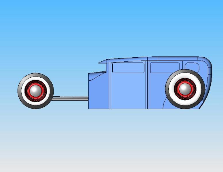

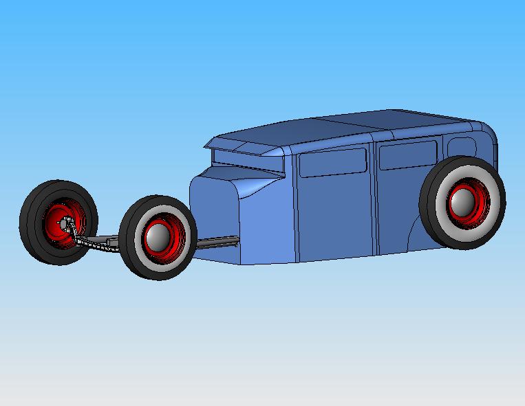

Wanted to make a quick update. Been working on the lower subframe. Dan, you were right about that being alot of work. Also been doing some design work/layout to prepare myself for the frame build when its time. Check these out!
