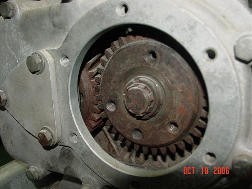

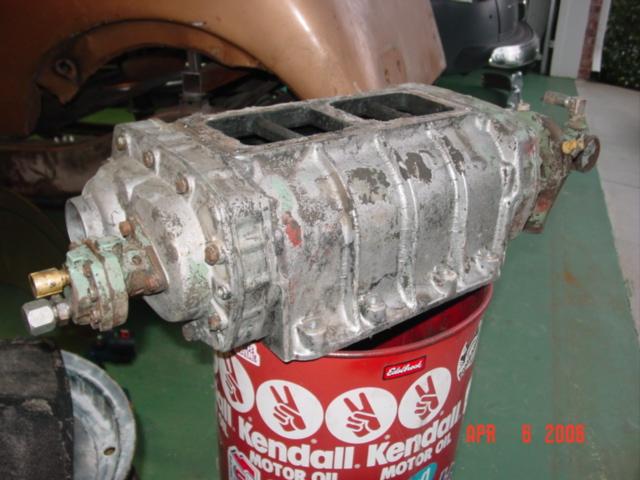

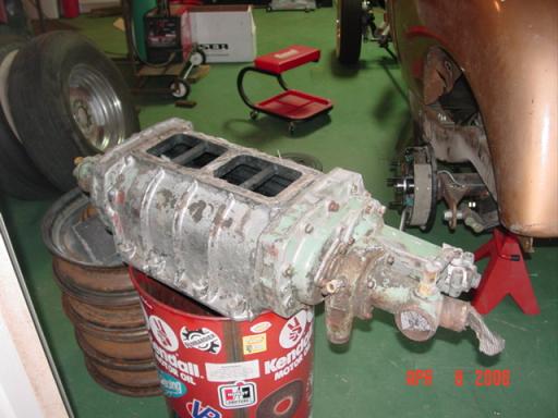

    Is it straight off the diesel engine? You may have to flip the rotors in the case so they are rotating the correct direction. The diesels drove them from the rear.
    The lip you have to cut off the bottom was from where it hung on the side of the diesel. It could be done easily at home with a grinder and some skill. Nothing has to be done to the top.
    the hot v groove set up is not readily available and will probably have to be custom made unless you can find one. They ran gilmer belts in the 50's and 60's. Don Hampton about cussed me out when I asked him to set me up a v belt drive. He said he'd do it but it would cost me. He also said the v belts slipped and were a pain in the ass since belts were defferent lengths. I think he was trying to make gobs of boost on race engines rather than a street engine. REJ says he runs his with V's no probs. I think the V's do look the best.
    I ended up with a 2" gilmer type belt since my car is 60's style anyway.
    I also spent 1.5 years on the phone with Don Hampton trying to get my 471 rebuilt. I sent him a 471 my buddy gave me that was straight off a diesel. He was cool the whole time, he just was very busy building race blowers and didn't want to stop and build my piss ant blower. I called him every other month or so and he'd say he'd get to it after race season or something else. Then he got slowed down when he got inducted into the Hall of Fame and was gone for a couple weeks! Like that is excuse - ha ha just kidding. He got it done and it is very nice.
    The hardest thing to come by is a cheap drive snout. You need to keep a close eye on ebay for snouts after you figure out how long a snout you need. The snout will bolt on the stock front cover, you need a coupler to go with your snout that has splines. The couple bolts to the blower rotor gear.
    Basically to convert a blower from diesel to street use they:
    1. cut the lip off the bottom of the case.
    2. change the rear bearings to sealed ones - these are available off ebay for like 20 bucks
    3. Flip the rotors in the case so the rotor drive gears are on the front
    4. Set the clearances on the rotors and case - then tripple pin the rotor drive gear to the rotor -this keeps the clearances between the rotors and case if there is a back fire. Basically the rotor drive gears can't spin on the rotor shaft once this is done.
    5. Replace the bearings and seals on the front of the rotors where the will seal off the front bearing oil bath - keep your gear lube out of the blower.
    6. Pin the bearing plates to the case once the tolerances are set
    You can get all sorts of aftermaket front and rear covers that replace the stock GMC pieces to dress up your blower and provide better bearing support.
    The pictures are of the ends of a 471 and there are two pictures of a 671 straight off a diesel with the diesel drive still on it. the shiny one is the 471 Hampton did for me.

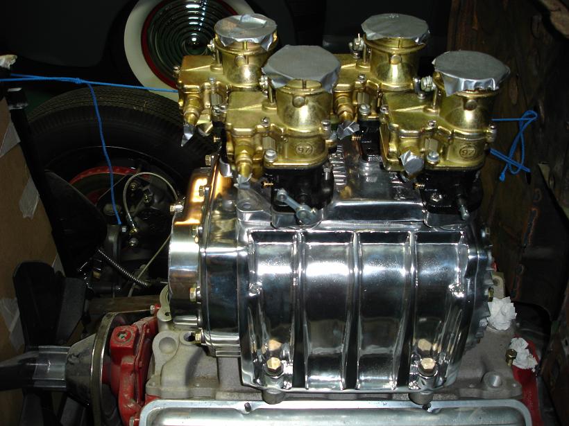

    Here is mine on the mock up motor.
    I DEFINATELY recommend Rick Dean. He is a retired racer/builder who lives for nothing but making and talking about blowers. Great guy.
    He can rebuild yours for well under 600 bills.

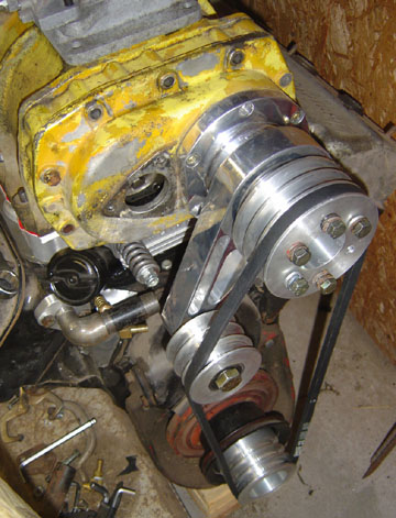

  27. Here's some mock up pics of my v-belt drive. If you have a lathe it's no big deal to make the pulleys. Funny. Making the drive setup didn't scare me but actually building the blower myself does. I'm going to send mine off to Rick Dean beginning of next year.
  28. nice work - it will be ready to dust Flamedabone RIGHT!! Looks like a little under drive -what is your intent?
  29. The goal is to have her running the blower this spring. I've got one year to get Flamedabone. Once he gets his blower motor built I won't stand a chance. I am a bit tired of just seeing his taillights on the track.
    Yep, it's underdriven. She's primarily street driven so I really don't want to get to radical but it sure is tempting. With the old hemi (read expensive parts) and no o-rings in the heads I'm going to keep the pressure down to around 5 to 6 pounds. Should get me pretty deep into the 12's if I can hook it up.
