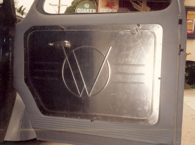

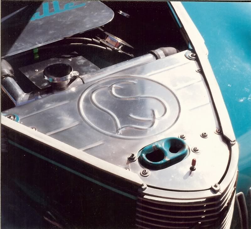

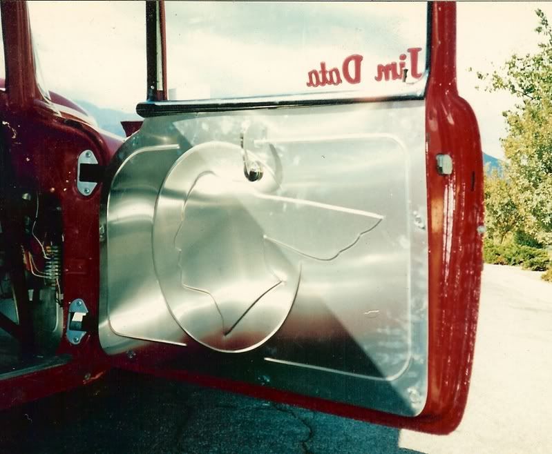

  2. I had a back yard hot rod fab shop for 12 years and did alot of sheetmetal fab and bead rolling. Here come some pic's of some of the bead rolling I did. It was fun to get creative and add a little style to door panels etc. I worked on street cars and drag cars.
