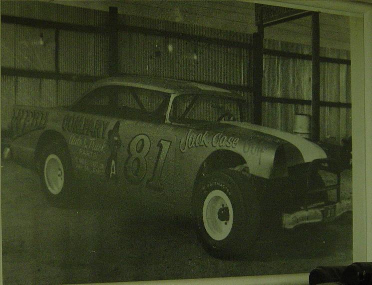

    I just found this pic of my pops.....maybe you should radius the wheel wells. hahaha
