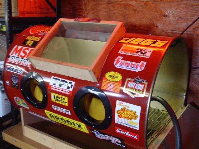

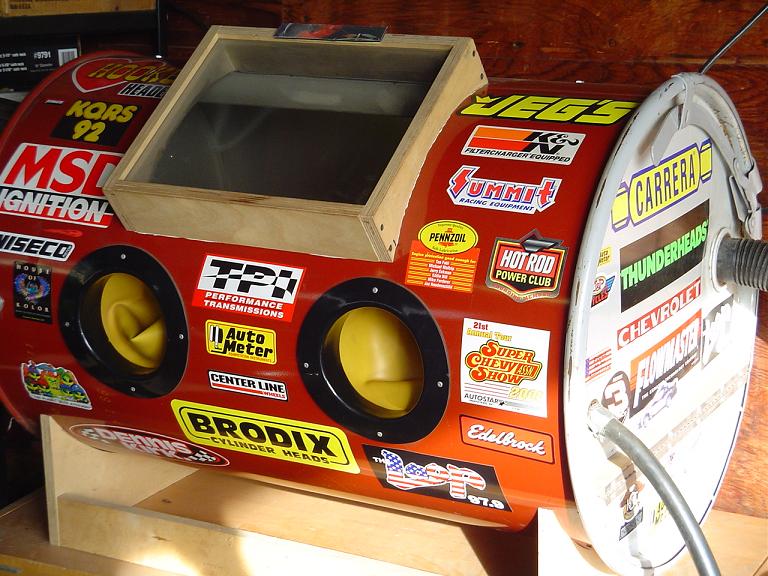

I spent about $40 for everything and already had some of it lying around. It sure beats blasting parts in the driveway. Here's how:
  • First I started with a clean 55 gallon barrel. This is the type with a removable lid. I got this one for free and it was clean on the inside. You’ll have to search around for one.
  • The door: I cut the lid as shown and added a piano hinge ($5) for easy access. The existing holes were the perfect size for the shop vac hose and the blast hose inlet.

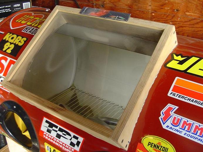

  • The window: this is just a simple box made of 3/4" birch veneer plywood that screws together with a slot on the inside to slide the glass in and a radius cut on the band saw to fit the barrel. After I had a good fit I marked the inside on the barrel and cut the opening, added some silicone sealer and screwed it on from the inside. I cut the glass from an old window I had. I made one side of the window box removable for glass replacement because the glass gets pitted after time. Tempered glass might be best.
  • The arm holes: I vacuum formed these out of 1/8” black ABS plastic over a wooden buck. These were riveted on. Use sealer to keep the sand in. This can also be made of a steel tube large enough for your arms. Just weld it in.

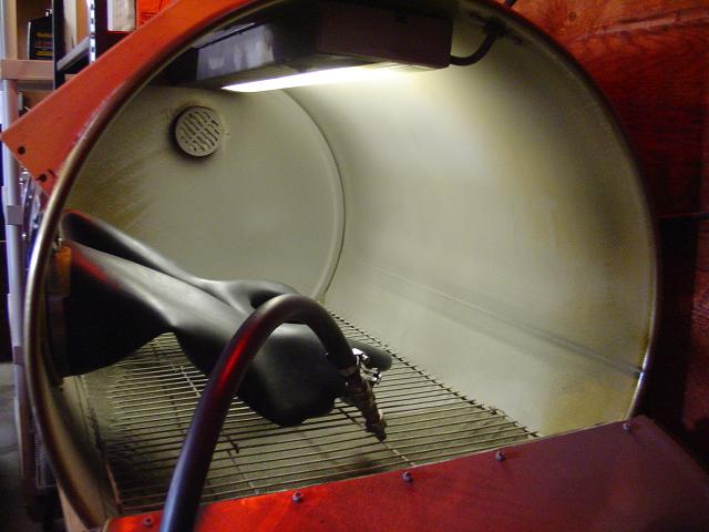

  • Gloves: The flange going in (see above) is where the gloves are attached. I used some thick industrial rubber gloves from the local surplus store ($5) and put a large diameter hose clamp around them on the inside to hold them in place.
  • I found the fluorescent light at a garage sale for $2. Home Depot has them too. This is self contained with the ballast inside. Two nuts and bolts hold it in place. I used some silicone sealer around the edges of the lens and corners to keep sand out and drilled a hole in the top of the barrel to run the chord out with a grommet around it.
  • The rack on the inside came out of an old refrigerator. I will upgrade this eventually but hey- it works for now!
  • I added a vent on the opposite end from the vacuum hose inlet. This helps keep the air clear inside so there is not a lot of dust flying around.
