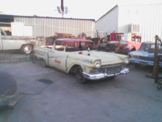

  19. blue57ford
    Joined: Jul 24, 2005
    Posts: 491
    blue57ford
  20. blue collar guy
    Joined: Apr 14, 2004
    Posts: 1,068
    blue collar guy
    That looks like a whole lot of fun. I've been kicking around making a 57 ranchero I have into a Gasser. Scott
