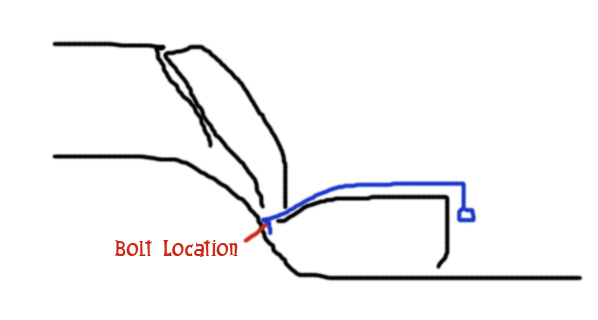

    I installed rear seatbelts in my Valiant. There were no holes for the rears, so I drilled my own and used big ass ROUND (important, square plates will tear the floor in an accident and possibly come free) washers under the floor. Most kits come with the bolts and 3" washers.
    Spacing was easy, I just eyeballed 1 side, wacked the spot with a punch (can't remember the correct name of the tool) and then checked under the car to make sure that the hole would clear the subframe and any body seams. Once 1 side was done I used that side as a template for the other.

    The other thing to check when marking the placement of the holes is that you want them in line with the top of the seat.
