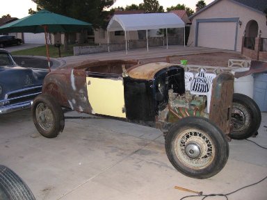

    My '25 Chev roadster quarter panels arrived from the US and I have mocked it all up. I am also sandblasting small bits, tomorrow I shall buy some Molasses so I can drip & strip some very very rusty Chevy parts.
    ps Is anybody else playing with Chev bangers? Or am I all alone?:D :confused:

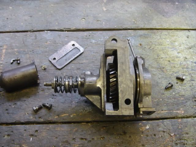

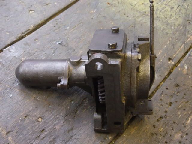

    First off is a governor that came from Artiki.
    These are a straight replacement for the timing gear side plate and were used to eerrmm... govern an engines speed when it was used in an industrial application.
    My long term plan for this is to convert it a side drive for a second mag/dizzy, oil pump, water pump or whatever.
    This is how much I dare take it apart as going beyond this point would involve knocking out pins and drilling out rivets.
    I would rather have it complete rather than in a million pieces while I am storing it.

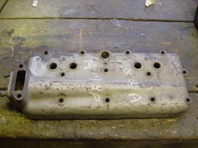

    Managed to pick up this pair of Winfield SR's at the big Beaulieu autojumble. Quite a find here in the UK.
    One is missing a couple of parts and they are only the baby 'A' size but they have their chokes, linkage and came on these neat elbow intakes. With the upright mountings I'm thinking they were for a Fronty head.

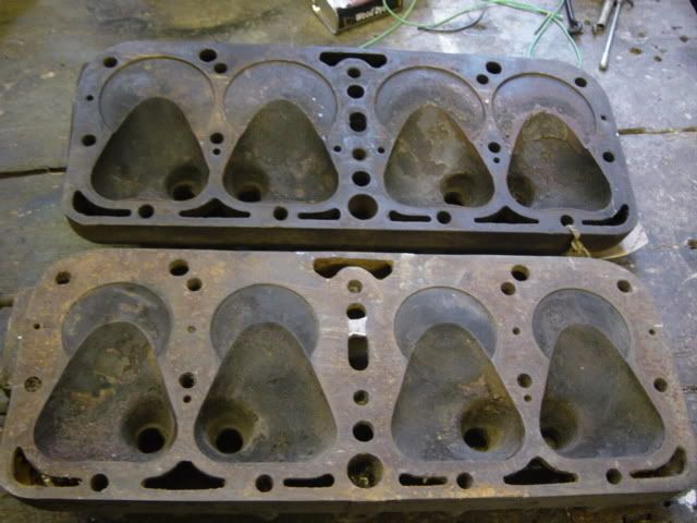

    Finally not new but here is the pictures of the 14.9hp Model 'A' head.
    From the outside it looks totally stock, well it should do as it is a stock Ford piece.
    This is a back to back comparison of the combustion chambers with a 'C' head. I should of used an 'A' but I didn't have one to hand.
    You can really see the difference here in the size difference of the piston relief and combustion chamber.
    The size difference are:
    14.9hp - 24hp
    Piston relief.
    3 1/8" - 4"
    Combustion Chamber Depth.
    3/4" - 1 1/4"
    If you wanted to fit this to a 24hp engine you would have to have the piston relief machined out to 4". Of course there is no denying that it would be a factory high compression. I like to think of it as a great "cheater" head.

    Ha! I knew there was going to be a big spring in that governer. It would've disappeared if I'd taken it apart, I'm telling ya....

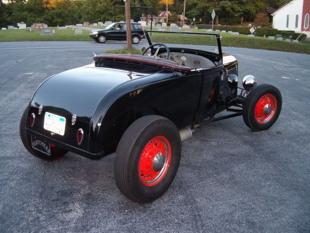

  16. I like it! It does remind me of my own though!
