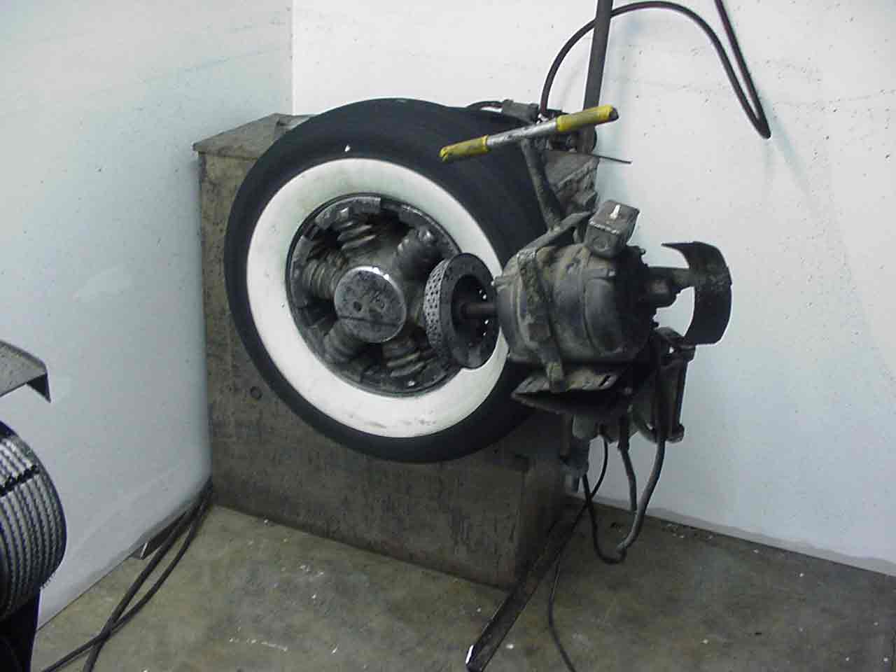

    It's commonly known that you can use a grinder to make your own Wide White Wall tires. I've been doing it for years. Heck, there's even a How To in the Tech-o-Matic. I try to describe the process to people, but am often met with blank stares and "you're pulling my leg" looks. Still pictures just don't really convey just how easy it is to do.
    So, last time I made a set, I filmed it. Here it is, explained step by step, shown for the very first time with moving pictures and Monophonic sound, How to make your own Wide White Walls:
    For anyone on dial up, here's a much smaller(and lower quality) version of the same thing: http://www.youtube.com/watch?v=e9d57F_8vDc

    I've been grindin' whites for a while and have found that the Kumho model #795 tires work great. They have a nice crisp outer edge.

    I ground out my skinny whites and they look good from 10ft. The passenger side looks good from 5ft since I learned my lessons on the driver's side!! If I would've seen this prior, they'd all look good from 3 ft. :cool:
    BTW, some white plasti-dip or fusion paint will clean up any little burn throughs you may have.

    Nice post, those discs seem to make a huge diffrence over the solid ones.

  27. Very well done! I'm not a wide-white kinda guy (I run blackwalls on everything), but I still want to try that. What is the brand name on the see-thru disks? Those definitely would be cool for many applications. Thanks for the fine effort! A great tech week post.:D
