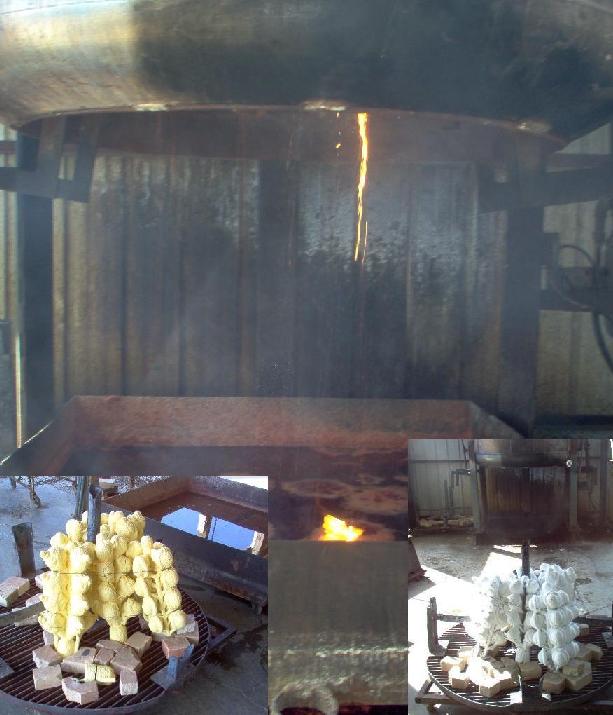

here's the next step of the process. in the lower right you can see the shells with wax still inside them, ceramic dipping recently completed. i've made sure the tops of the cups have been cut off to allow wax to drip out, and drilled a few vent holes in the main sprues so ease these things as the wax melts. the main picture is of the loaded kiln, wax dripping and burning out of the shells. this kiln is a large stainless chamber with a propane burner and reaches 1500+ degree f. a hydraulic ram from an old garage lifts the rack of shells into the kiln where it is held by a pair of levers and the ram retracted. wax runs out the grating that makes the floor of the rack. after the wax stops, about an hour later i pulled the shells, slightly glowing from heat, out of the kiln and rolled them to a safe spot to cool. the white shells in the lower right are the freshly burned-out shells, now ceramic molds. gonna pour tomorrow or thursday, stay tuned.
