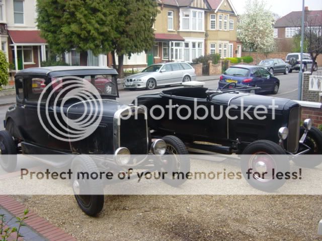

  12. A picture before it all went wrong.
    Tesco trolly, the better choice because of the flatter base!
