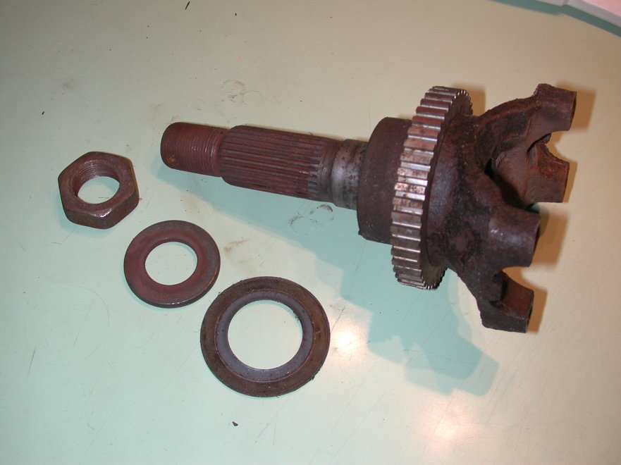

I finally decided to look into setting up an electrolysis rig just to see if it really worked. I had two spindles from the Corvette rearend that I am using for my Merc, both were rusty and I didn't relish the thought of spending an hour or so with the wire wheel on them. Here is the one that I have yet to dip, it is not as bad as the one that I finished but you can see the rust on the yoke and spline...

This is the other spindle, it sat in the electrolysis dip for about 6 hours. As you can see, the rust is gone and the metal looks almost new. I hope that the pics show the detail...
