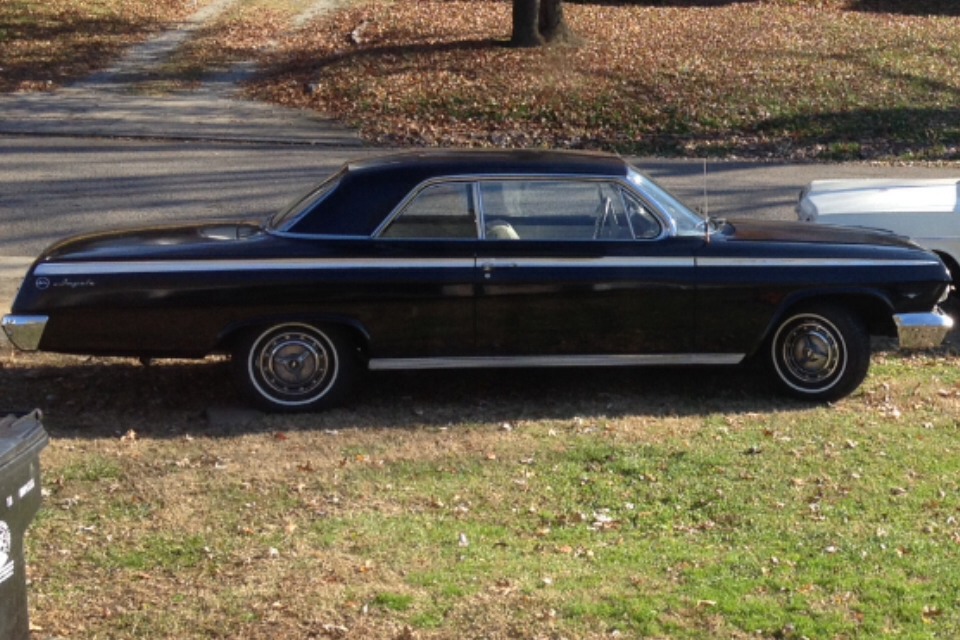

    I have a 1962 impala and I want to change it from a 3 on tree an auto on the column. I have an Original column shift, a fresh short tail th350, torque convertor, and a flex plate. Can anyone em tell me what else I need, where I can find, and or directions on how to do the job. I'm a newbie!

    Thanks guys, I have a 283 in it and yes I have a new column. It's new to me, original to the year. Is there a place online I could maybe find directions or a how to? I'm a car newbie, I just love the art in motion of an old car. ImageUploadedByH.A.M.B.1390494896.593145.jpg
