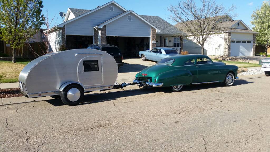

  25. This is an awesome site full of every idea possible!! Here is a pic of mine that is nearly completed. 4' wide 8' long, perfect for the 2 of us to crash in at the shows.
