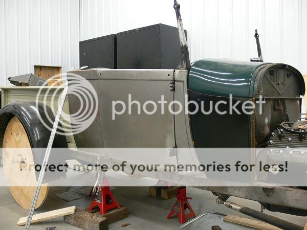

    working on my 28 RPU and having a time getting the doors to line up with the quarter panels. i remember i had to put shims under the cowl section on the sedan i had.
    on this im not sure what to do to be correct. the door seems to be running up hill and the quarter sitting straight.
    i do have a few shims under the front of the cowl which helped a little. the gap on the inside of the door isnt to bad any thoughts or suggestions??
    when i first took this thing apart there were aprox 1/2" pieces or rubber under the cowl section.

    Doors running ''uphill'' as in towards the quarter? Replace the 1/2''+ of shim thickness @ the cowl, with some plywood spacers, and work on your alignment issue from there.

    As I look at the picture you posted from a front quarter view it seems to me you need to raise the back of the body. I looks to me that your door and cowl belt line do line up, but your body tilts downward in the rear. Just my thought.

    the rubber shims are gone. today is when i stuck the maybe 1/4" of shim under the very front of the cowl to see how much it changed it. uphill sounded good to me as i have the rear panels sitting flush with the bottom of the subrails
    thats what i had thought also but when i lift the back panel to make the belt line match it almost makes the gap at the bottom of the door to quarter to large to the point of almost being able to see through it
    yeah thats what i am worried about i dont want to have a huge stack of shims up front and the hood not fit. this is a stock from that i have boxed that i took a lot of time doing trying to keep it from moving. seemed good and level after i was done. it has all new subrails and subrail extensions from brookville as well as quarters and cowl post..which took some working to get to even fit close to the top of the gas tank.

    there is only supposed to be one rubber washer at the front of the cowl. looks as if u need to lower back of body and adjust shims under rear of cowl for alignment.

    Any shims in area of rear of door opening? It looks too high there,lower the "center or raise the rear.....only way to change things without raising the whole cowle a bunch.....

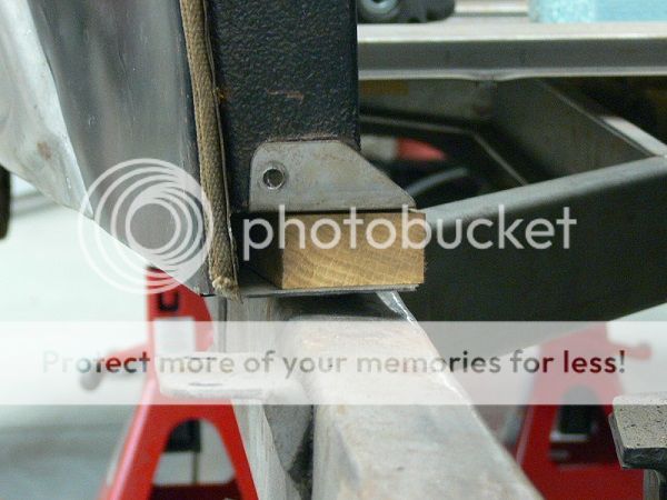

    Currently i have about 2 washers under the sub rail in the furthest front bolt hole to make it sit the same height off the frame as the sub rails by the door opening but i dont think i measured it clear at the back.. will check on that.
    Only shims are the two washers in front as of right now

    Forgot to add that the blocks came from Brookville
