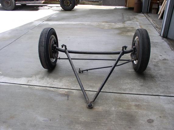

    part four, day four of my Modified
    I wasn't gunna werk on the thing today but I couldn't help myself [​IMG]
    here's how I split my '36 Ford front wishbone.
    I rolled the frontend outside
