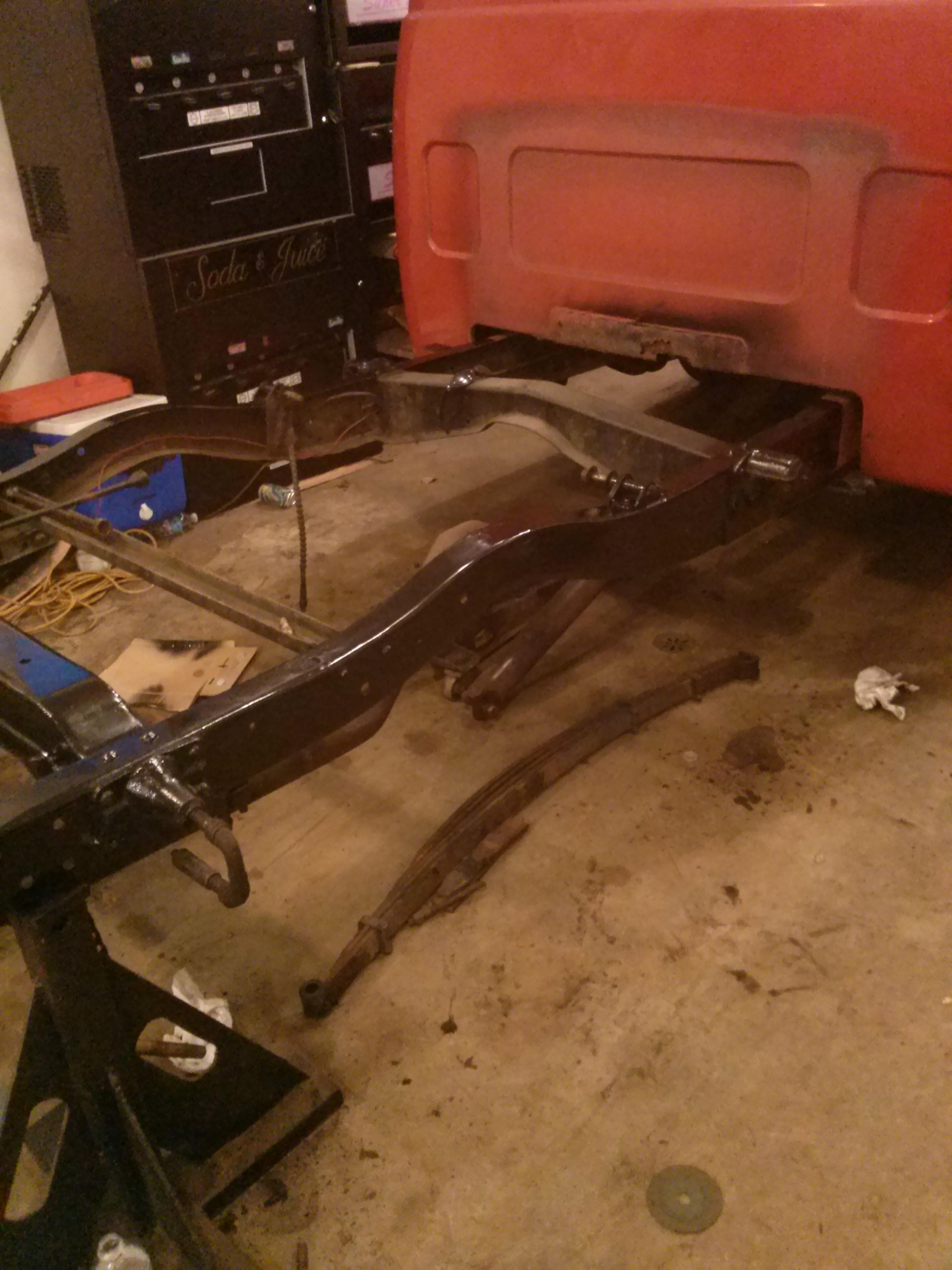

    Rear frame grinded all down ready for paint
  7. 57maaaat
    Joined: Jul 16, 2013
    Posts: 48
    57maaaat
    rear frame painted
