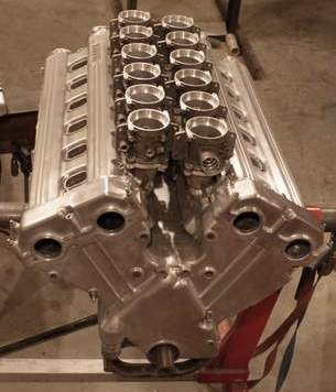

    For some time I’ve been thinking I wanted to build a wooden boat. Then I got distracted trying to stuff a V12 in my car (an 84 ferrari 308) and now that the end is at least in site on that project I’m thinking about the boat again…..and V12s…..so last weekend I drug home a Lincoln V12 thinking what could possible look and sound better in a 1940s looking boat than a 1940s looking engine.
    Now here’s the problem….I know very little about flatheads in general and nothing at all about Lincoln V12 flatheads. A quick search of the forum found me a few V12 projects but not a whole lot about the engines themselves….so I’m thinking a V12 build thread is in order.
    Here's a few shots of where I'm starting from:

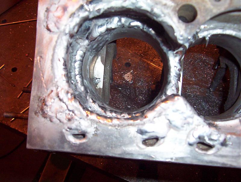

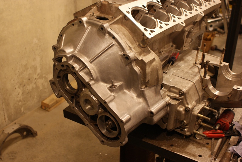

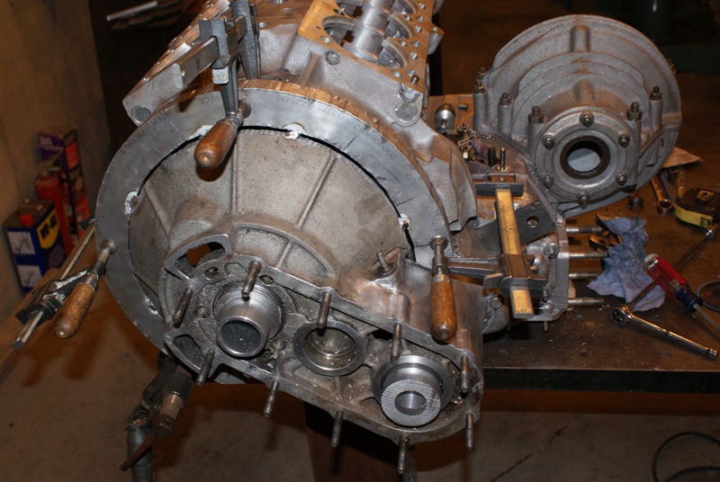

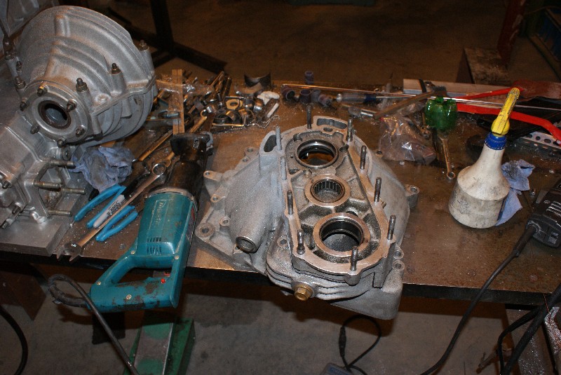

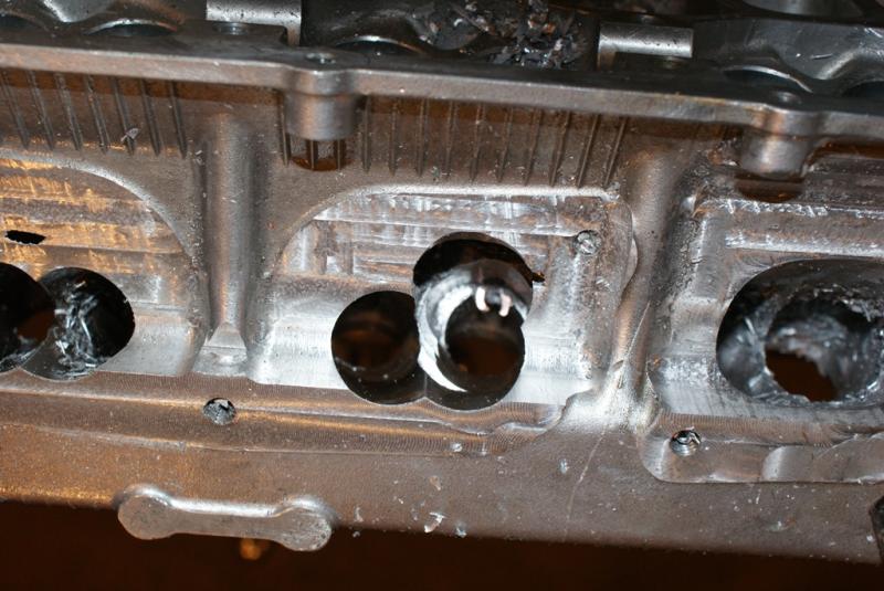

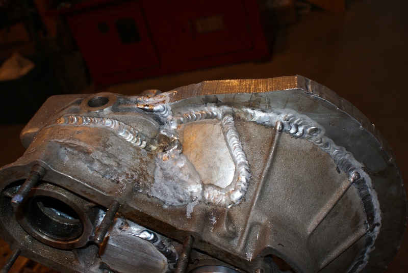

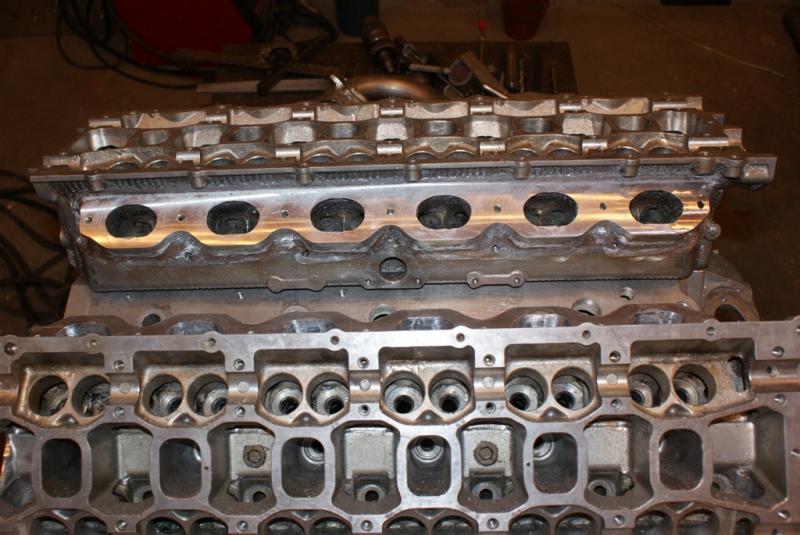

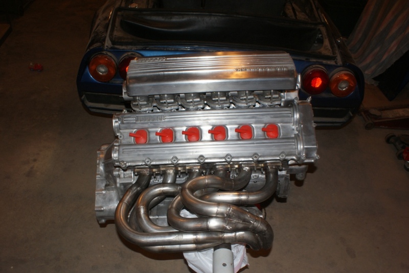

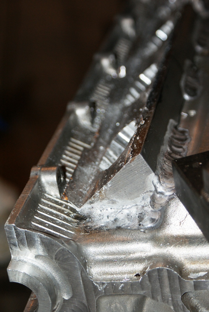

    Here's a couple shots of the V12 that is just finishing up. It's a 1982 ferrari 400i block, with 1984 testarossa heads force fit on it then the that force fit onto the 308 trans.
    ....lots of sawzalling and welding and re-machining
    but now on to flathead Lincolns :)
    edit: added the finished bellhousing and heads shots

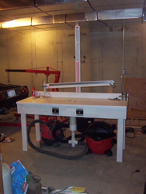

    I have a flow bench I built which should help with the porting and head selection....if I can figure-out how to get the block lincoln on it and connected.

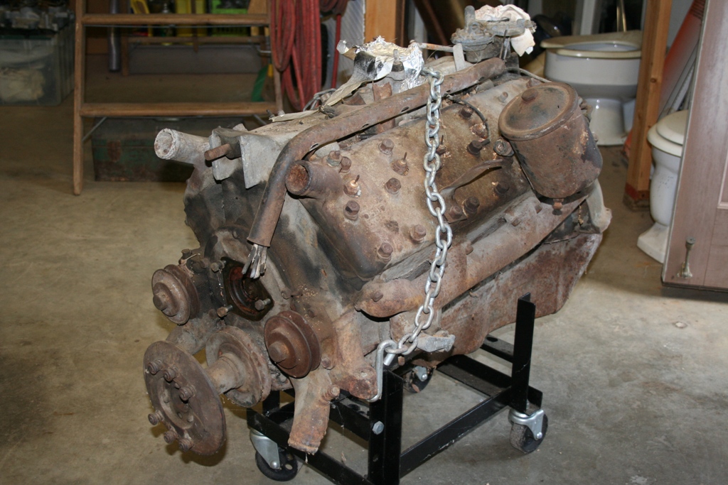

  8. Well looking at the block that you have I can see that it is between a 1946 to 1948 block which is the better one to use for your project. Also when you are tearing down your engine look on the inside edge where the oil pan bolts on usually there are issues where some cracks were found due to water left in the block from sitting for a few years mostly due to cold weather. If you need more info do not hesitate to call me anytime at 1 (800)7640406 I can help you with this one.

    I just started the tear down last night I'm going slow and trying not to break anything so all I accomplished is the starter and oil pan off.

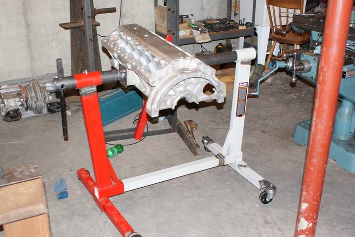

    Question - what do you guys do for an engine stand?
    When I hung the ferrari V12 on a stand for the local autoparts store (it was like $50) it bent the stand and I know the lincoln engine is heavier yet. My solution was 2 $50 stands plugged together and just grab the mounts on the side of the block and is really solid.
    The 2 stand creation is a little harder (possible though) for the lincoln though so I'm wondering if one of the "heavy duty" $129.95 type stands from summit, jegs, etc, actually hold this engine safely?

    I would want double support, either sideways or lengthways. Even short, stiff engines like 350 SBC sag measurably with single support. Someone on Fordbarn pubished a simple tech on modifying 2 cheapies...I would think only real issue would be slightly changing the axial tilt of the holding part.

    I'm thinking you're exactly right...I was just hoping to hear "oh yeah, man you'll be amazed how good the heavy duty stand is"
    All i did to use 2 cheapies on the ferrari was to plug them together then sawzall and re-weld the heads to point at each other. It was pretty easy, probably 2 hours for the whole project.
