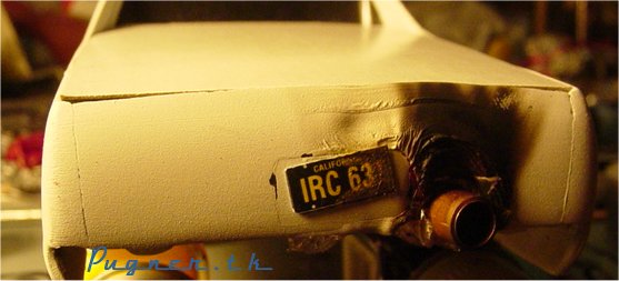

  23. Ha ha.. Are you serious thats you? Well im New Jerseian, i took a elky model , put propane into a tube running under the chassie of the car.... Shoots foot high flames ... Burnt my hairs too....
    I got some vids, if you wanna see them, just give me your email..
