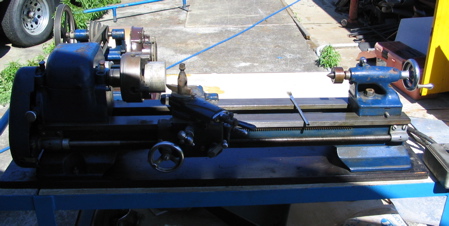

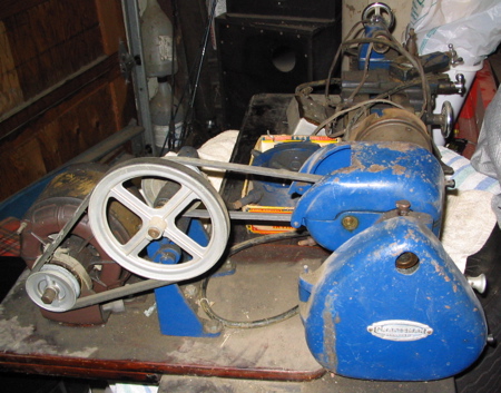

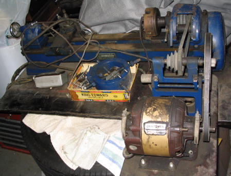

  1. I got a great deal on this old Craftsman metal lathe in a garage sale yesterday, along with hundreds of pounds of old machinist tools that went with it. I found a big set of gears for it in one of the boxes. It has a four jaw chuck and I'm hoping there's a three jaw chuck in one of the boxes.
    Anybody recognize this model of lathe and know roughly how old it is? Is it worth fixing up? It seems pretty solid and everything seems like it works okay except for a couple of broken off spinners on the knobs. I'm used to working with bigger lathes at work sometimes, but this thing could be fun to play with at home.
    Is there a site to search for info on old Craftsman lathes? I searched around and couldn't find much.
    Thanks!

    What you have is a Craftsman model 101, 6" metal turning lathe. this late was built by the Atlas machine tool company. Clausing bought Atlas and you can still buy parts for this lathe from Clausing. There are always a lot of parts and peices for these lathes on Ebay.
    I have owned one of these lathes for 25 years and have used it to make numerous small parts. It is a very good machine. Looks like you made a good score.

    Yeah, it's pretty tiny, might be fun to make some knobs, spacers, bushings or small stuff like that on it when I need to. I guess I can cut threads on it too if I figure out how all the gearing works. When you swing that side cover open, there's a maze of about a dozen gears in there. It came with literally hundreds of different custom ground cutting tools for cutting o-ring grooves and stuff like that. It will definitely come in handy someday once I get it running again safely. I'm going to start by replacing the old cracked up 2-wire power cord with a grounded one.

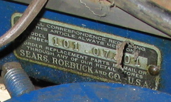

  11. I saw a little plaque on the backside of the lathe in one of the pictures and I zoomed in and found the model number: 101.07301
    So that should help me narrow down when it was made and who manufactured it (Atlas maybe?)
    Yeah, I will definitely need the drill attachment for the tailstock and a 3 jaw chuck, but hopefully those parts are buried in the boxes of stuff that came with it.
    Thanks!

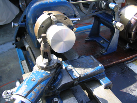

  13. I spent almost a whole day cleaning up the lathe, and making lots of adjustments and fixing little things on it. Everything seemed pretty good, so I faced off a big hunk of 2-1/2" aluminum rod that had been cut rough with a saw, and it did a pretty nice job. It's a pretty small little lathe, but it does a pretty nice job. I just need to make a better base for it than the plywood one it's bolted to now.
    I found out it's the older style made for Craftsman by Atlas, probably in the early '50s. It has a 1"-8 threaded spindle and babbitt bearings, but after messing with it for a while I got it to run with only .001" of up and down slop in the spindle. Not bad for a machine that's over 50 years old.
    I think I'll keep it!:)
    Thanks for the info and leads everybody.
