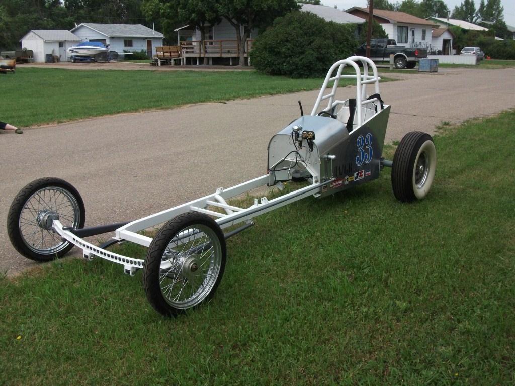

    Well here goes
    a couple monthes ago i came across a for sale a HA/gr on the web. i looked into it and found a beautiful well built and engineered HAMBster for sale.
    here is the build thread for those who want to see http://www.jalopyjournal.com/forum/s...d.php?t=488608
    I contacted the owner Skip Pipes and we talked back and forth and I commited to buy the car. the deal was with a built 292 6 and a poweglide trans. I have no one near with this kind of car and it may be the only one in my province of saskatchewan so the engine and trans were not an issue
    went down with a long box truck dismantled the car loaded it up and back north it came.
    I must add that skip is an amazing fabricator and had put together a really nice car, he and his family were very freindly and down to earth.

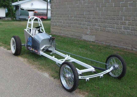

    The car came back and is now in my shop , i have got it put together as a roller and will slowly start getting things put together on it.
    I never took any pics of it in the back of the truck or when we unloaded it but i wish i did cause its hard to believe it all fit inthe back of a truck even the way i packed it.
    here are some once we got it together as a roller

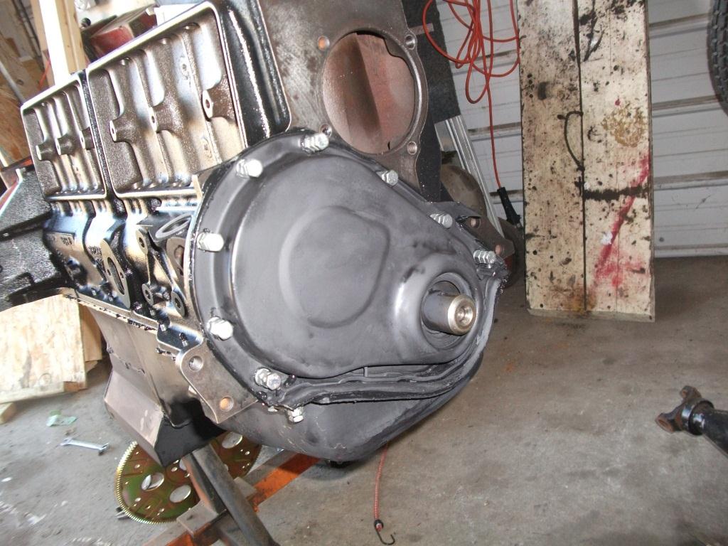

  3. canadianal
    Joined: May 15, 2012
    Posts: 164
    canadianal
    from canada

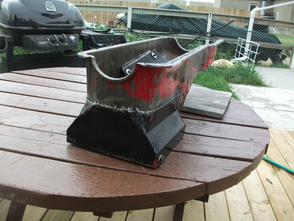

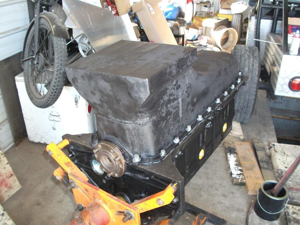

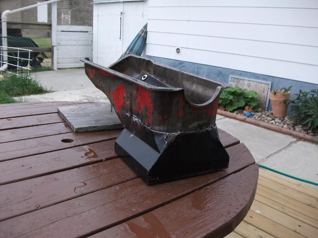

    I worked on the 292 oilpan today and grafted a 350 deep pan assy to the bottom of the 292 pan it actually worked pretty darn good , a little hinkey at the front as the pan is about 1 1/2 longer than the deep pan . worked out ok though. i don't know if i am going to put the windage screen screen inside though. This isnt a super high rpm motor that would gain a lot from an scraper and screen as long as the oil gets back into the deep hole at the end.Ran out of mig gas so will have to wait to finish

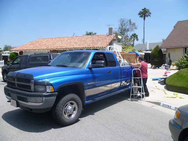

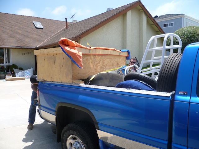

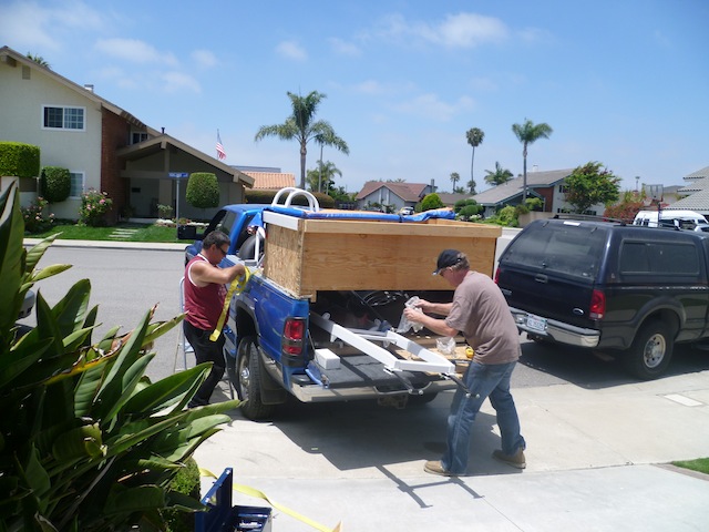

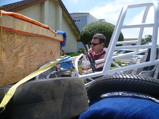

  7. I got pics.
    Al is an amazing planner; he got everything in the truck and home safely.
    Skip

    And I didnt think anyone took any pics of that :eek: it made it back to Canada the border guys never even blinked an eye and no troopers stopped me on the way home . ordered the 6 cyl performance tech book and its on its way.

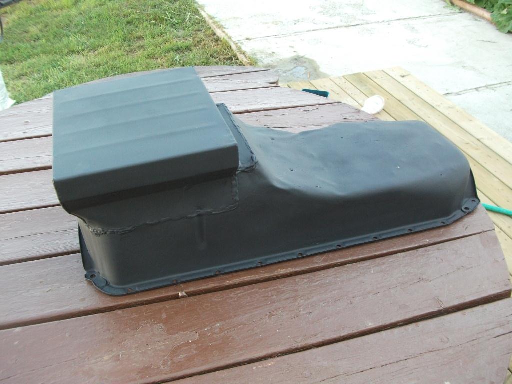

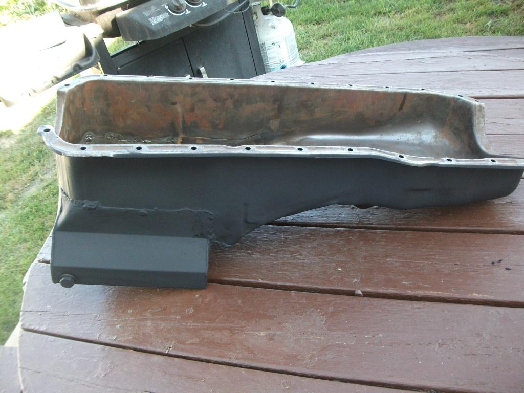

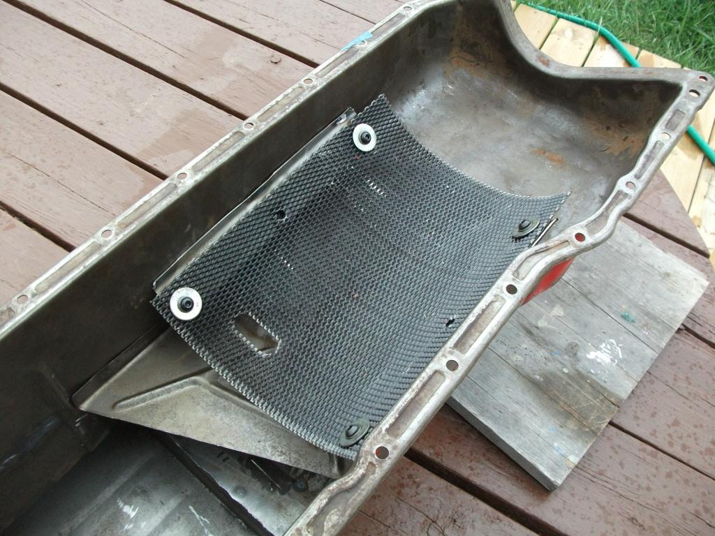

    oilpan finished,dont look to close at the welds, man tough to weld old oilpans !! turned out good. no leaks

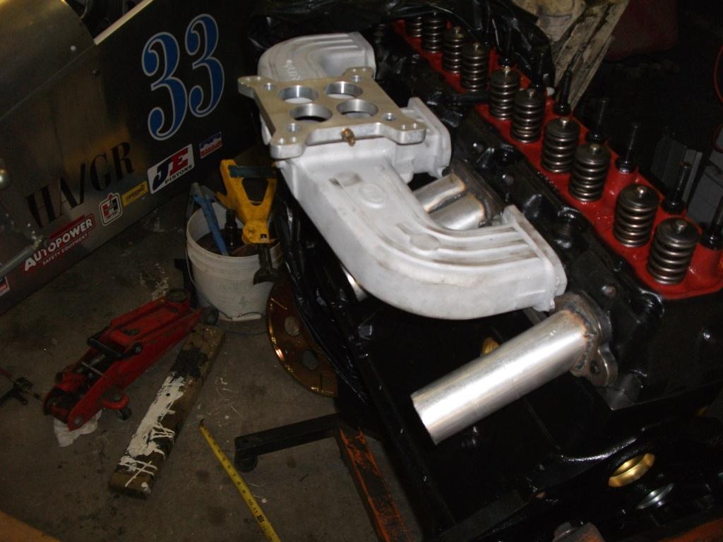

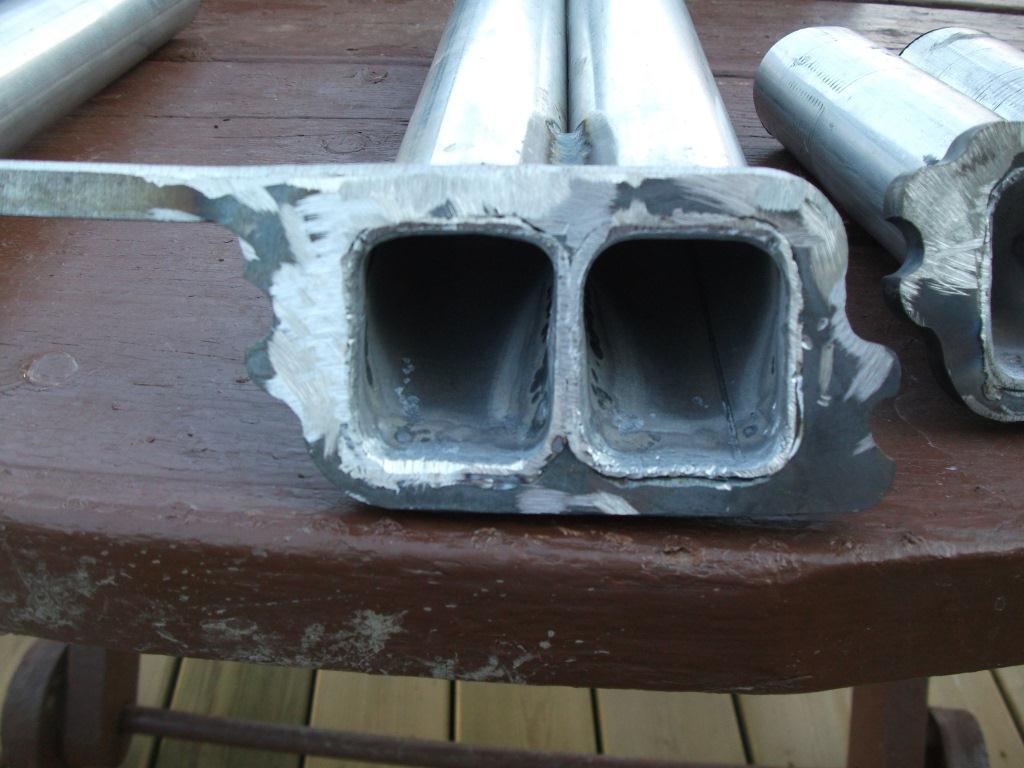

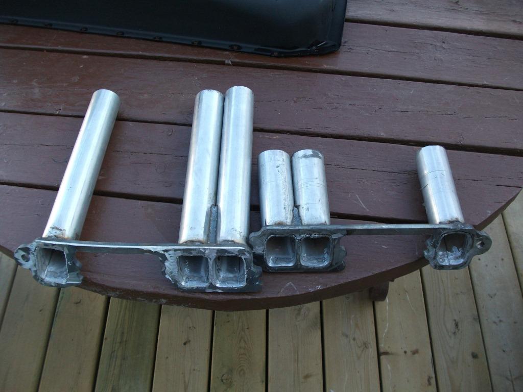

    also a start on some kind of headers
    am going to just do a simple 90 degree back and stagger the pipes so the front 3 and rear 3 go into a ovaled 3/12 inch collector pipe and exit on the lt side of the car.
    i resisted the uge to make the collectors go staight up like a puller tractor and have 2 flappers on top:)

    Al, pan looks like it will hold a couple of quarts extra, did you add the baffle/screen to it?
    Good start on the intake and headers. Your moving right along.:)

    Olds 28 no I didnt put in the screen it only fit a portion as the pan is so long. I also dont have a oilpump pickup so I wasnt sure about fitment.
    I was going to leave it off i was more concerned about oil supply and capacity.
    I was just in the shop looking at the exhaust i may just make up a simple set of zoomie turnups and wrap them in header wrap . dont know yet will see how things turn out.

    Header flanges and stub pipes , have a little finishing left on the shorter ones but they turned out good .
    Anybody tied to cone or shrink 4 inch exhuast tubing but not the whole length ? Like if a 4 ft pipe only the front 2 ft whould be shrunk to a cone. would cutting a lonng angled sliver from the pipe and then rolling the cut pieces toether work. I would think it would work at the far end but progressivly harder to do so as you get the smaller part of the piece cut out.
    I am trying to do it all myself for one reaseon I am a long way from the places that make this stuff and also because that would be what one would have to do to build something like this back then except with a stick welder:D

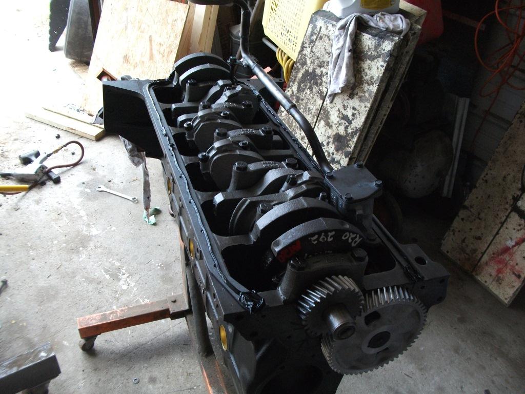

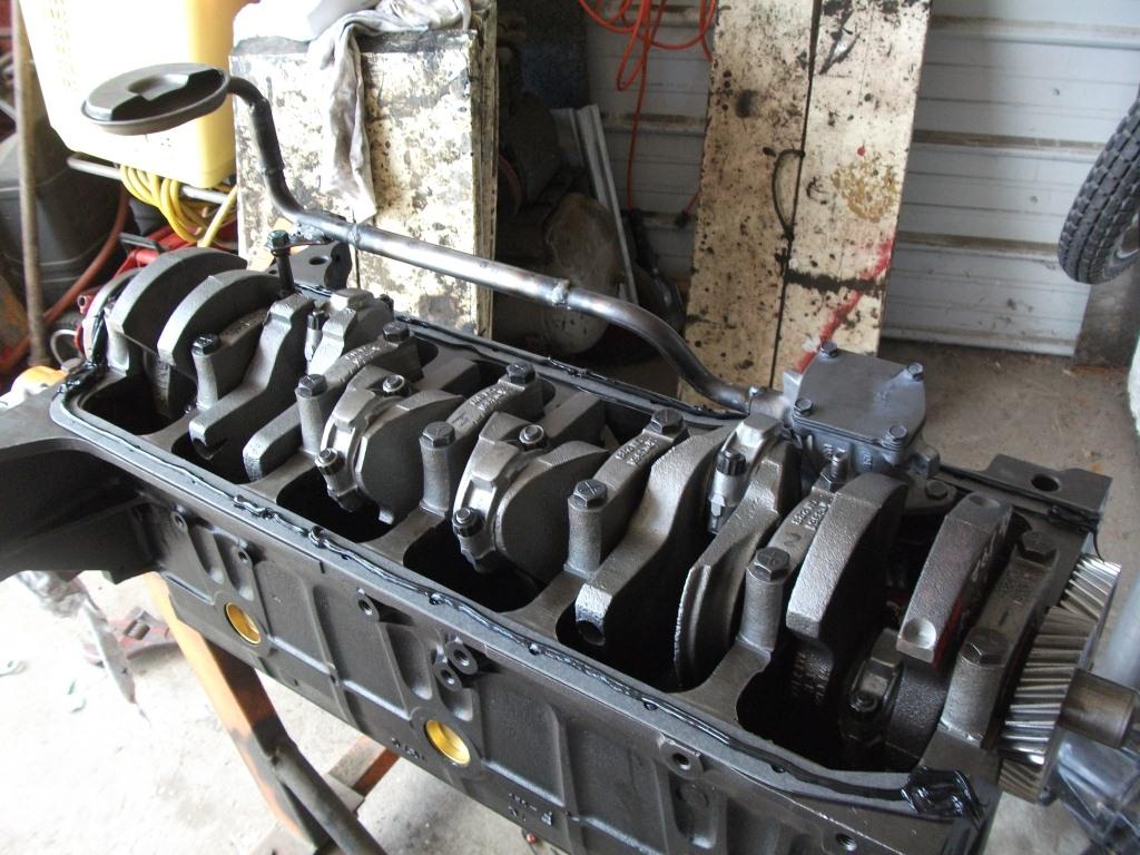

    got the ther 292 its froze but not bad will soak it for a while to get the pistons out.
    on a positive note got the bottom end buttoned up today with a modified oil pickup its ugly but functional and got the pan and timing cover pan dipstick tube. timing chain oiler all in. Should have ordered the head stud kit as could have gotten that together this weekend.
    Does anyone know the ramifications of running the engine with whatever is supposed to be in the upper large journal in the oill filter fitting. the other engine has a little spring loaded flap in there ??

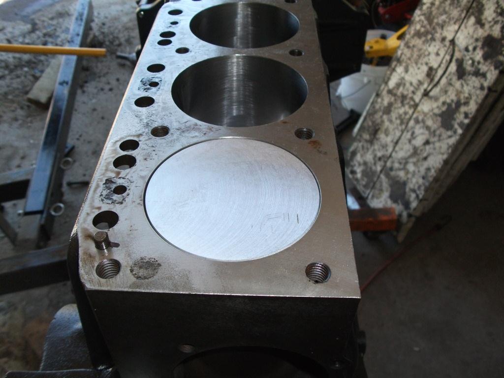

    Hi Al, I sent a lot of PM back & forth with skip as he came up with the 366 piston idea and I will be real interested how the combination works out.
    In the picture the piston looks to form a -0- deck condition. Is the piston at a true -0- deck or is it down in the hole a few .000th? Can you measure the depth and let me know.

    Old sparks the round bolt that comes with the kit replaces that head bolt, Skip pipes explained to me that the area being compressed is smaller soa better seal can be made on that potion of the head. I am also getting a arp head stud kit also to make shure the lid stays on.
    Old 28 I will check the piston depth onece i get my body mobile today.

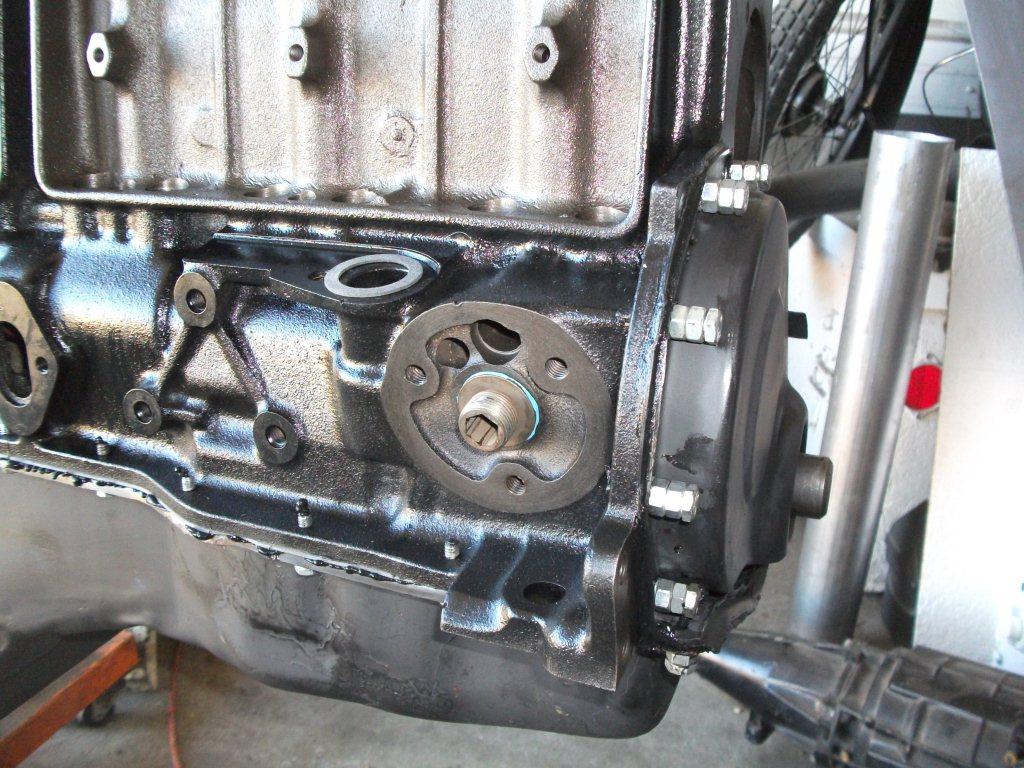

  27. Al,
    The large hole in the oil filter housing is for a check valve; you have to run it. If your parts store can't find it I'll send you one.
    I'm sure someone won't like the Zero deck, but the head gasket thickness will give all the clearance you need for a race motor. As this is a "racing" engine (not a street car) you won't be able to run it on unleaded pump gas, but as I said, we know this is a race engine.
    Here's the scoop on how to convert a 1-wire alternator. Fairly inexpensive and easy to do for a thinking man (like you). From a very trusted source!
    http://purplesagetradingpost.com/sumner/techinfo/onewire.html
    I thing the oil pan came out great and I'm pleased you did it; you won't regret it.

    I measured the pistons with a feeler gauge not quite 0 deck between .40 and .35 thou might as well be 0 deck.
    I figured it out skip re the oil bypass and i would run one up here especialy as it can be pretty chilly in the mornings even in sept and october I am shure i can get one at the local NAPA parts. Ive seen filters explode in the pits. I will have to get a new harmonic balancer as the one on the doner motor looks pretty rough will track one of those down this week.
