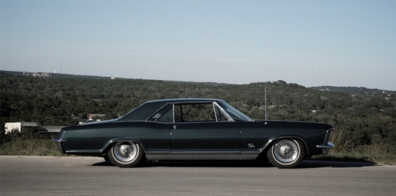

Here’s what we saw:
By most accounts, Rivieras should sit dead level front-to-back and this one does at this point. I’m a little concerned that the front will settle more than the rear, resulting in a forward rake, but I’ll deal with that when/if it comes.
